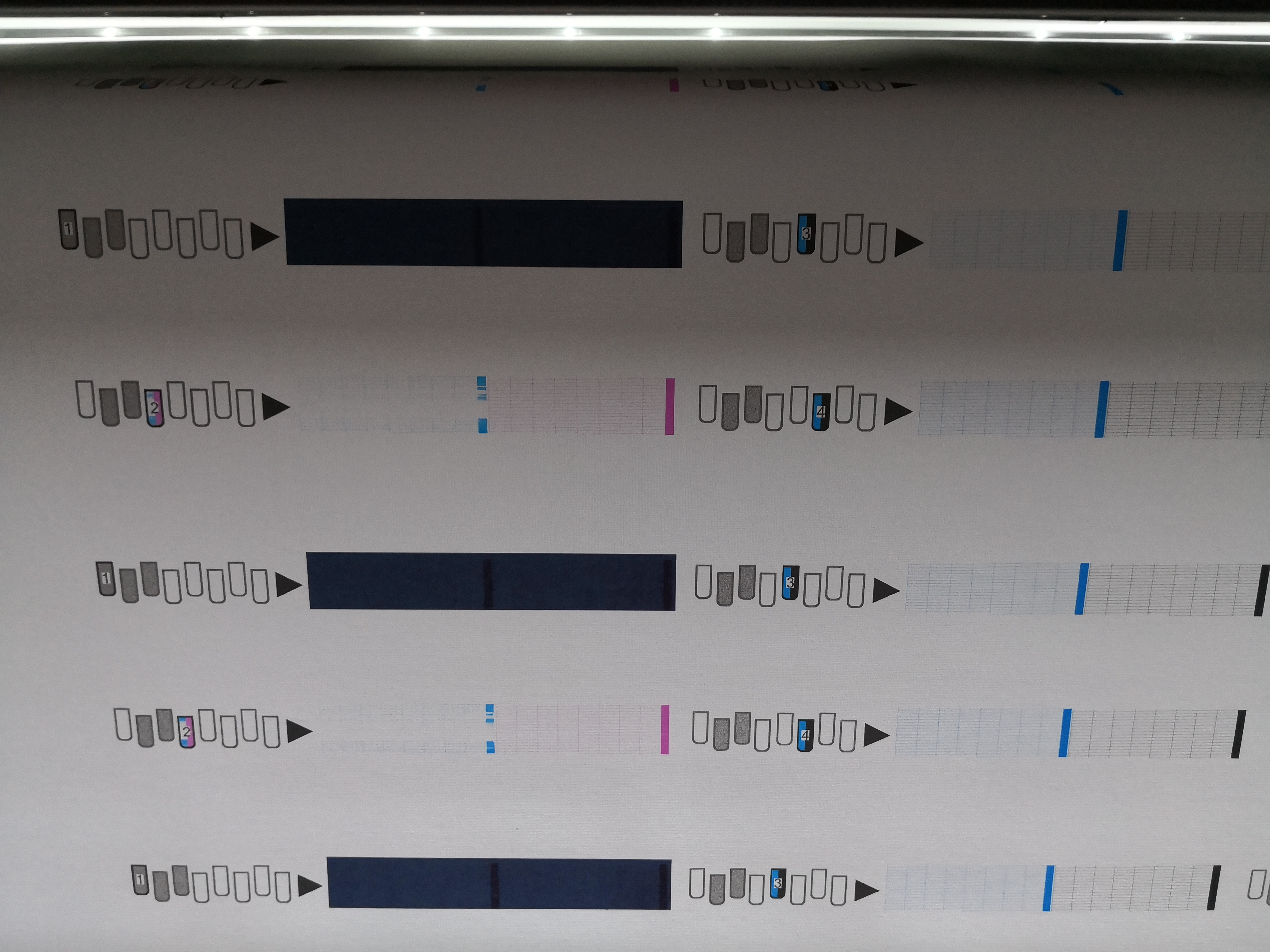

After replacing the empty LC ink cartridge, all prints went bad. Printed printhead status plot and LC was completely missing. Cleaned all printheads a couple of times and LC partially came back. (see attached image). I thought a few more cleanings would solve the problem but they didn't. Probably 10 more cleanings were done but the LC still remained the same.
Does replacing the LC/LM printhead would solve the problem? Before the ink replacement, everything is ok. Why would replacing an empty ink cartridge could cause the printhead to fail? strange.
Anyone could provide some color? Really appreciate any help!

Never had one fail to a change. Is it under warranty? I'd call hp... They'll send a new one out 2nd day to you. A failed head isn't a big deal..it sucks, but we just buy a backup of each and warranty any failed ones we have.
Niwo
Thanks for the reply! I purchased the machine last summer so it should be within warranty. You are right, a failed head is not a big issue. I hope it's just a head failure, not something else.
ikarasu
If you.goto Printhead and click It, it'll tell you if it's in warranty or not.
Did it ever say potential print quality problem? Sucks that it's a Light ink.. every other ink has two heads, and you could.just swap to make sure it's the head.
You can try a manual cleaning. I had my black heads die after the machine say for a week...did 5 cleanings and it was still bad. I did a manual and it came back.
It's a last resort before doing a warranty exchange / throwing it in the trash, but at that point you have nothing to lose...and it might get you back up and running.
Did you shake the cart before inserting it? Or try removing and shaking it some more, try another cleaning and see if that helps.

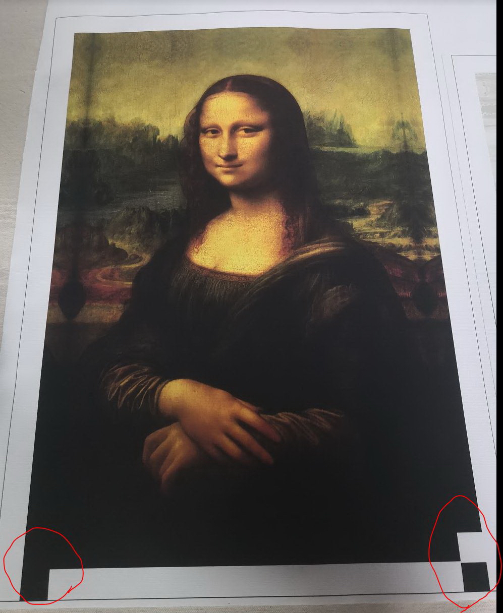

Well, when it arrived, Flexi crashed all the time. After some back and forth with their support, they fixed it by sending me a file to replace what came with the original package.
What forced me to switch to Oynx is that Flexi is totally unusable for my application. You can see from my attached example it's not able to print the bottom corners, which are mirrored. Their support acknowledged the bug but let me wait forever for the fix. They never got back to me.
Also, it doesn't provide the most basic feature to print fold marks. I have Canon's photoshop plugin and Qimage that provide these feature, not to mention Onyx.
I have to say Flexi is not for me at all.

Hi yes if you have tried cleaning that printhead and it didnt resolve the issue then i would replace it. Check the warranty date on it though, it might still be under hp warranty so Hp would replace it free of charge. Also be sure that nothing is done that is not done through the screen first. that includes replacing the ink only after you have told the printer that you would be doing that. Also, do not turn the printer off ever as this stops the computer from doing its own maintenance. We love Hp latex and sell many. thx Plottermaster
Thanks Carlos! Yes I think I made the mistake just replacing the ink without following the on-screen instruction. won't do that again. also won't turn off the printer again. You guys are so great!

FrankW
The problem with the corners is solved with build 2898.
