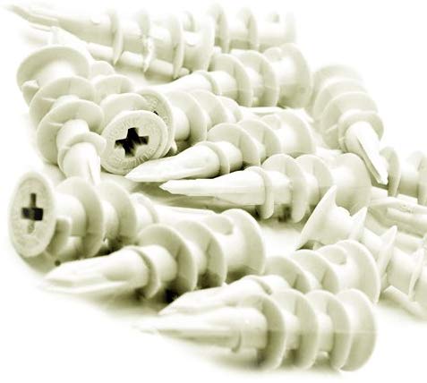

visual800
on that size you should be fine with these anchors. I use the big ones. these things are strong
ams
Agree with this. They are quite strong. If you are using stand offs in the middle, you could always put those in a stud for extra support.
