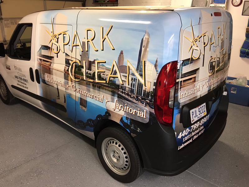

Just finished wrapping this one with new Avery 1105/1360Z combo.
All printed on my new HP330. Did not notice any issues with printing and not really any noticeable color shift between the panels.
Used the doors as a natural seams, I had to seam it towards the bottom a bit due to printing on 54" film (I have 55" laminator) and the the curve on the bottom of the door (Back panel would not reach that far to cover that curve completely)
Any comments? Good or bad, I'm doing vinyl for a while but since recently started pushing wraps a bit more. This is my third done and have a few more lined up in the next few weeks.
Thanks
