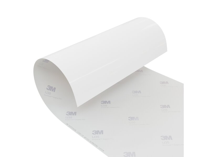

I’ve never seen any 3m vinyl without the markings on the liner. Found a photo of it online…doesn’t mean it all comes this way nowadays. I’ve used the ij35C and it definitely does. Even their lower end 50 series scotchcal does.

I guess there is a tiny 1"x.5" sticker on the inside. I had to take a picture of it and blow it up to read it. It says Product IJ35-10 Date 9-1-22
I'll maybe unroll a bit of it and see what the deal is with the liner. Like I said, it seems waxy on the bottom which I THINK is causing it to jam up.

I've used IJ35 for years and it does not have any markings on the backing paper. I stopped using it after they discontinued the 60" wide rolls.
