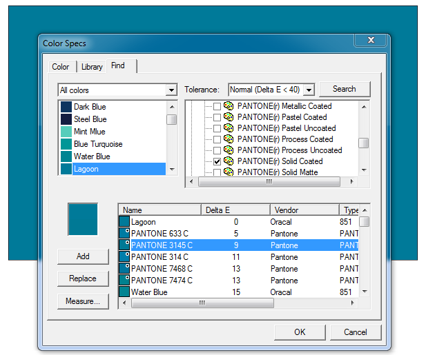

I am trying to match oracal 970RA color 553 Lagoon but my pantone charts are so old there is nothing even close. I have to send this out to a wholesaler because my machine is too small but the only way they can match the color is with a Pantone number. I really don't want to spend a couple hundred on new booklets for one job as I haven't needed them much. Any help would be appreciated! (yes I was ordering the color since it is a partial wrap but Oracal doesn't know when they are going to start making it again and I can't hang around, my customer has 5 vans waiting and between the half roll they have on the shelf and my half roll I am going to have to resort to printing it)

FlexiSign color search:
