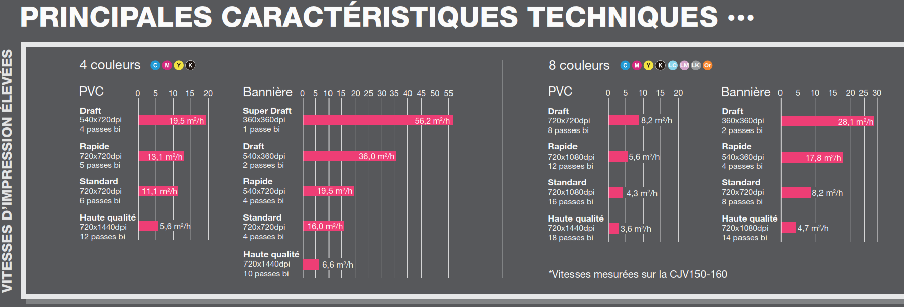

Guimb0
Catherineeee
Hi Guimbo, Thanks for the attachment. But is the speed of CJV150-160 is the same as CJV150-130? i am looking for 130.
Thanks in advance!
bilge
Scan axis aka x direction speed is faster than media feed aka y direction speed. The specified speed is full width speed. Printing speed 130 media on 160 width printer is the same as 130 media on 130 printer. So you may expect 20 percent lower speed on each section of the table.
