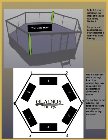

Hi Everyone,
Let me start off by saying that I'm not a big fan of UFC, but a client who owns a dojo wants me to supply banners and graphics for a UFC style competition. My question is, does anyone know what gets used on the mat, in the ring. They are selling six ad spots that people will be walking, wrestling, fighting on. I'm assuming that it can't be just printed vinyl. Might it be some kind of textile?
The whole thing is kind of a pain and if they weren't already a customer I would probably tell them to take a hike (politely of course, as to not get beat up). I just can't find any references to what gets used on the mat.

How much space do you need?
Could you use a latex paint? It would dry faster.
Is it just the one main decal in the center on the floor? It reads that the numbered rectangles represent ad spots on the cage...?
How big is the decal?
Fold the tarp up to the area and size of the decal. Cut logo out of calendered vinyl. Apply vinyl. Roll on paint. Remove mask. Let dry. Repeat if required.
