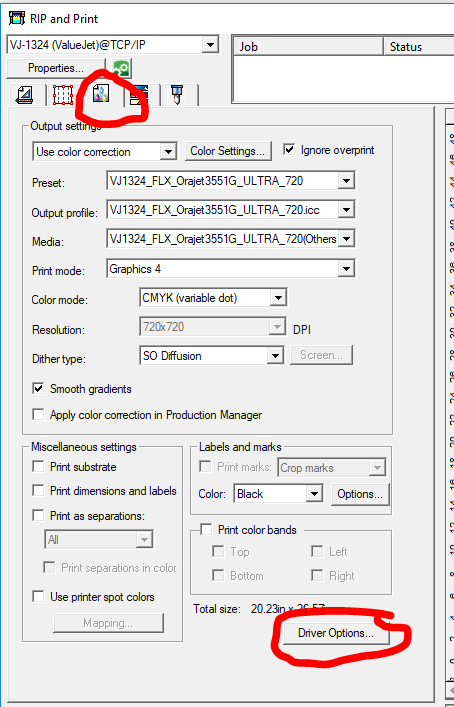

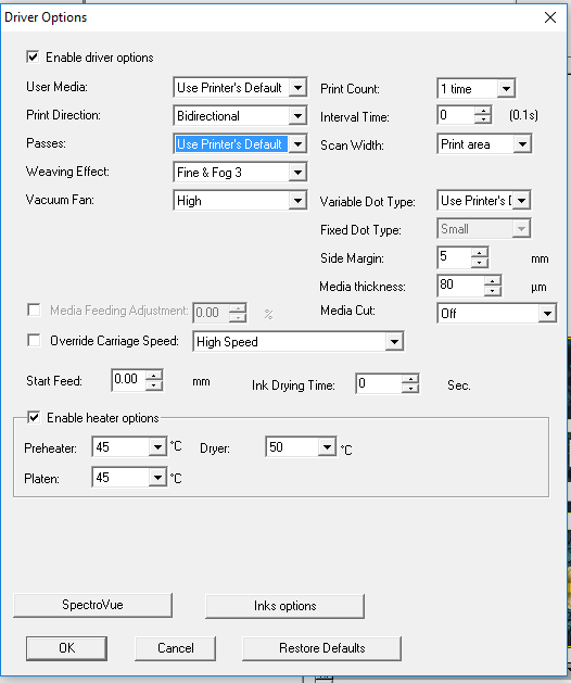

Open Rip & Print.
Click on color options..
then driver options..
This may be what you need.(passes or print count) I've not used either one so I am not sure.
I think you want print count...

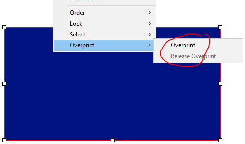

In addition to thezigman's post,
You'll need to set the graphic to overprint before rip and print..
Select your print image in Flexi, Right-click and select overprint

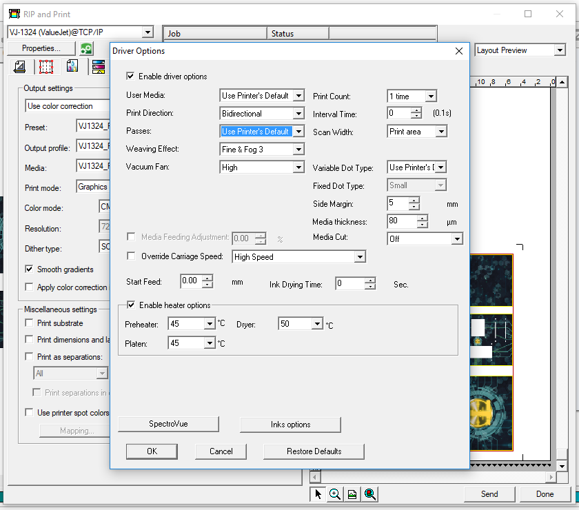

Hi
The printer you have selected is a Mutoh vj 1324. I followed the directions listed here with the proper printer selected HP Latex 300 series, the driver options window is completely different with no option to double print. I also cannot locate anywhere on the printer or from flexi.....rip and print or production manager.
I have a Mutoh vj 2606, a Roland pro 2 and the HP Latex 360. I am also using Flexicloud and can find double strike/print etc on all my machines but not the latex
any help here would be much appreciated
Thanks

......so just watched this video on youtube......if I understand it correctly, with the HP Latex series 300 it is all done from the profile selected.
