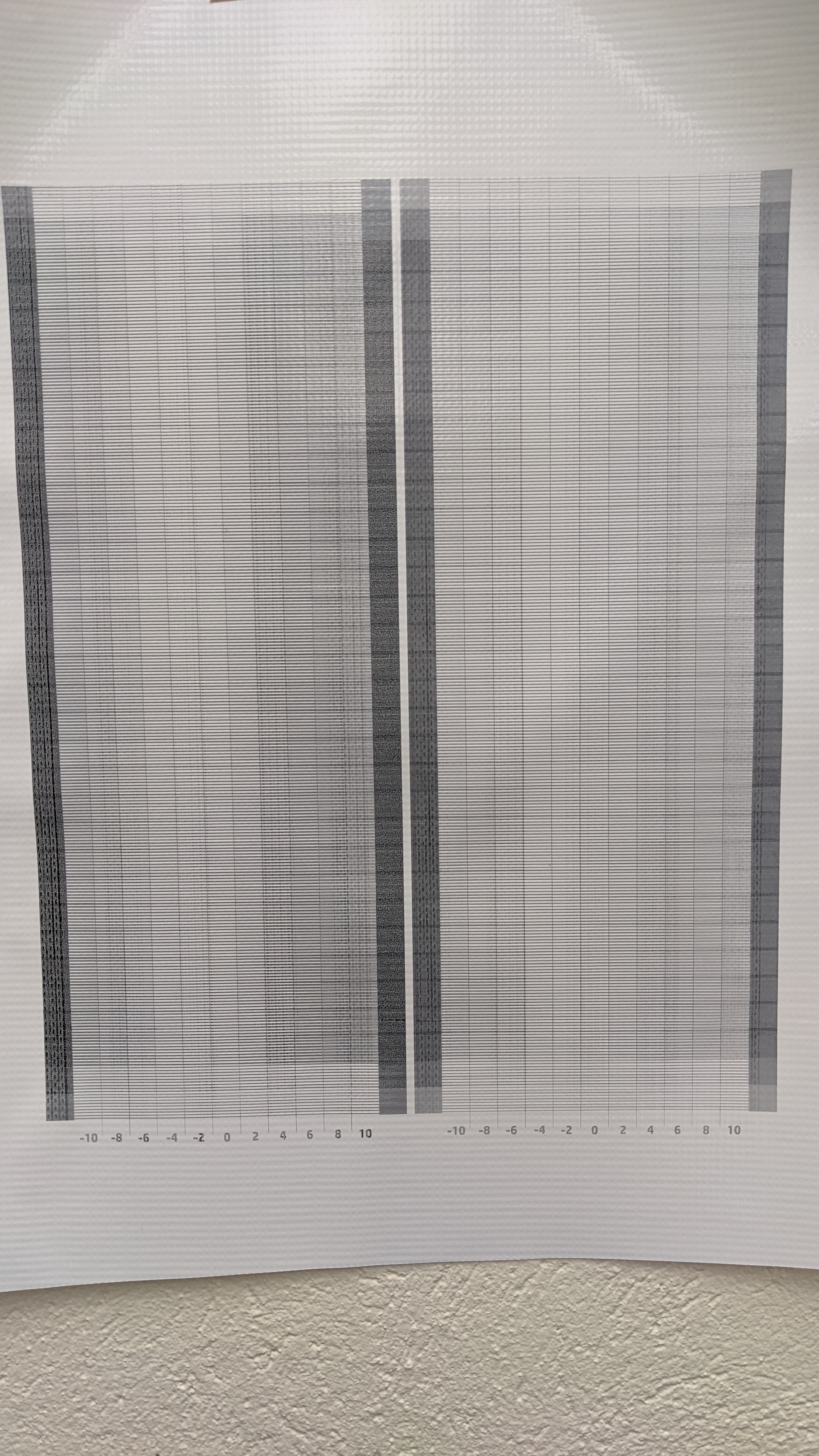

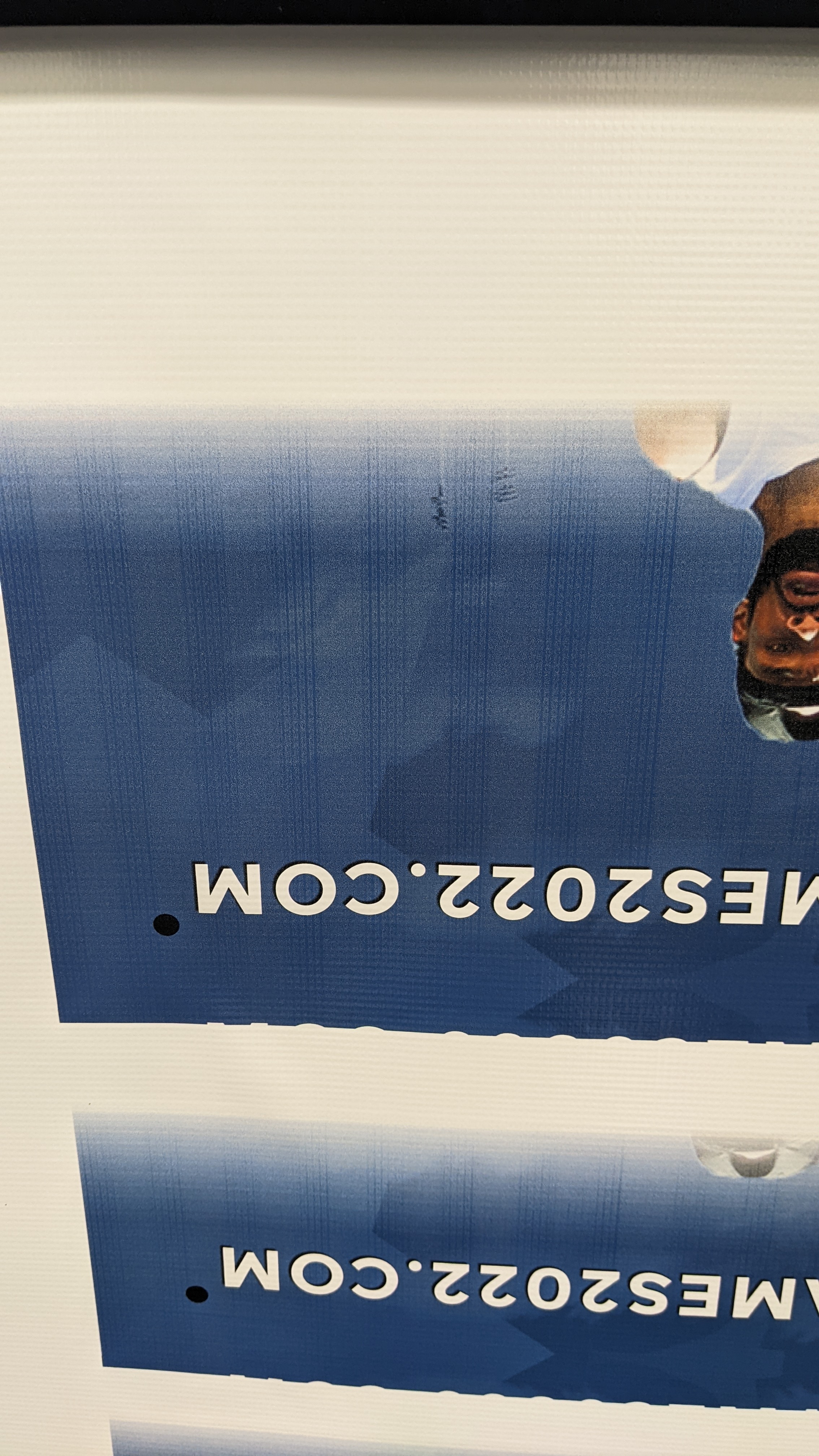

definitely have introduced an advance value, also running with no vacuum. I'm attaching a pic for reference of both the advance plot and the print.

Upsie, I meant horizontal banding. My bad.
That is definately fucked up. Not normal.
It would not be impossible that your trailing cable is gone bad. Maybe not but that is strange.
I don't know.

I'm only having this issue with one type of media. My 13oz Gloss banner material, 54" roll. The 63" roll runs fine, the 54" matte runs fine. I'm just going to use the 63" for now until I can figure this out. I live in Bermuda where we have little to no tech support/ service for these machines.
