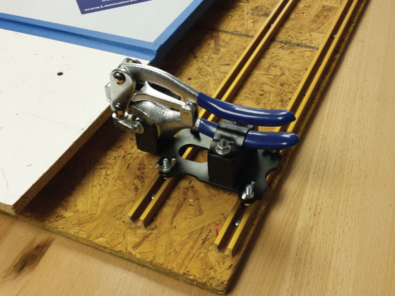

This is handy for mounting your hand punch to a bench: http://www.frednelsonfabrication.com/PunchMountSales.htm
We took two of these mounting brackets and put them on some T-Slot on a board to make a jig for repeat punch cuts.
