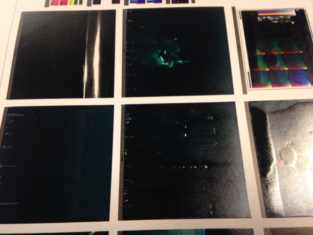

Hello,
I am just test printing for the first time with caldera and my Roland 545 OEM ink, and all of the profiles I tried are just dripping wet on the vinyl, gobs of ink melting the vinyl.
I figure something must be wrong, I mean its melting the vinyl with the pools of ink.
I just loaded the software and did some tests, I don't think I messed with any settings to cause this out of the gate.
Has anyone had this experience or know what it might be?
Solventinkjet
DIY Printer Fixing Guide
I don't have a lot of experience with Caldera but in Flexi there is a setting to use color correction that can be turned on and off. Even if you have a profile selected, it doesn't actually apply it unless this option is turned on. It seems to me that could be whats happening in your case. Usually when color correction is not turned on it lays way too much ink down.
