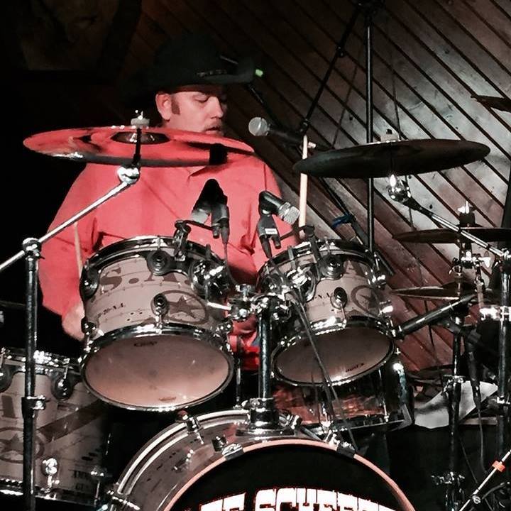

I have done several, and also am a drummer. I wrapped my personal set a little over 2 years ago using Arlon 4600 with Arlon 3420G overlaminate. I have had great results with it. My shells were a stained wood, so all I did was completely disassemble all the hardwear, cleaned with alcohol, and installed. It has held up exceptionally. We play about 130 shows a year, usually 2-3 nights a week, in different locations, so lots of setup and tear down. I even wrapped the wooden hoops on the kick drum (where the kick pedals hook on.) I also have wrapped kits with the sparkle type wrap finishes, without any other prep than what I did on mine. I noticed very little tonal change on the kit, which is a concern for drummers.

Wow! Thanks so much for that valuable information. Over 80% of our client base is the music industry, has been for 23 years, so having someone tied in to both sides like yourself is VERY helpful. Appreciate it.
