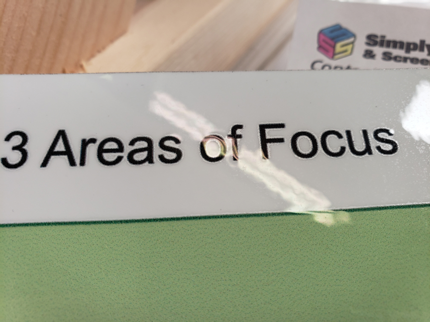

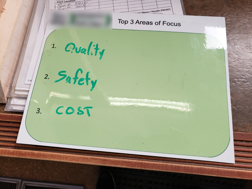

I am looking for some recommendations if anyone can offer any, for some dry erase magnetic signs. The customer brought in some that they are already using with great success and would like something similar to these, if possible. The only thing that I thought was odd, is that I'm only finding 2 mil dry erase laminates through my typical suppliers. These magnets look like they have a thick, maybe 6-12 mil laminate on them. The reason I say that is because you can see silvering around the heavily printed areas of the magnets, as you will see in the attached photos, that is typical of a thicker laminate. The magnets measure about .033" thick overall.
Does anyone know this mystery dry-erase laminate? Aside from that, does anyone have experience with a tried and true dry erase laminate that works well on magnetic signage? Since this is a new product for us, I just want to make sure we put our best foot forward and not use something that will cause edge curl or other potential problems.

That second photo really looks to me like they laminated over cut lettering. Normal dry erase laminate should work just fine on prints or directly to blank magnet. And your .033" makes sense.....030" magnet with 3 mil laminate; adds up.

It's definitely printed. You can see the same silvering along the top edge of the green, not to mention I can't imagine anyone in their right mind putting vinyl lettering on a printed magnet unless perhaps if it was variable data, which this is not. I've generally seen this occurrence when a very thick or rigid laminate is applied over a densely printed surface.
You know you make a good point. I actually thought this was a vinyl print with thick laminate applied to .025" magnet. I guess it could be printed directly to the magnet and then laminated over, but the side profile, which I did not get a photo of, looked like it had vinyl and laminate applied to a slightly thinner magnetic sheeting.

And if I was asked for this - I would probably print on vinyl, lam with vandalgaurd anti-graffiti lam, then mount to 30mil magnet. I've tried direct printing, then laminating with the anti-graffiti, but the UV ink is raised a little and it doesn't look as good. kind of like image 2. Vandalgaurd is awesome - you can get sharpie ink off of it with ISO alcohol and a little elbow grease.

Second photo to me looks like that’s just vinyl + dry erase lam mounted to a magnet. That graininess in the print is a dead giveaway.

So, after looking at my work order again, it says it is .038". Obviously, I need to work on my handwriting. This is definitely a thick laminate. It looks just like a Convex 12 mil laminate, but for dry erase use. So yeah, essentially I'm looking for a thick dry erase laminate, or so it would seem.
Could the text have been "flatbedded", DTS? I found that if you lay vinyl over a DTS piece you will see an impression from the text.
