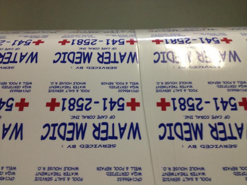

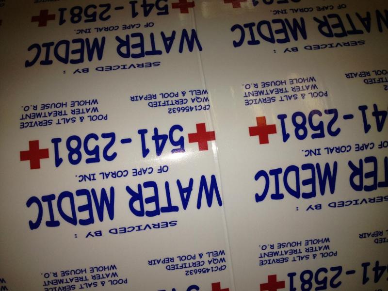

Hey guys, I am getting some creasing on my vinyl for the lamination. My tension seems good, the vinyl has no creasing prior to entering the laminator. The laminate also appears to go through the rollers without any creasing. This laminator is 4 weeks old. Any ideas ?

One would think that the tension is too tight at the ends and pushing the material to the center. Have you tried reducing the pressure at both ends equally?
