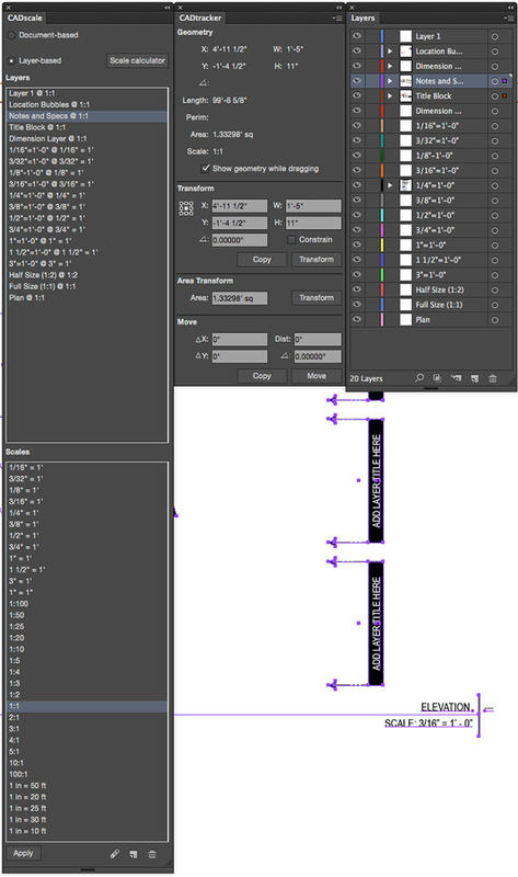

I use CadTools with Illustrator
I have a template set up where my layers are assigned a different scale. That way I don't have to have single page scales. I can have multiple pages/artboards and have as many scales as I need, all color coded. If I change the scale of the drawing, I can pull the drawing to the adjusted scale.
