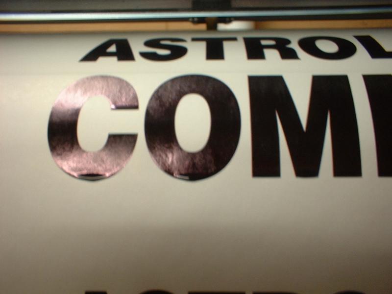

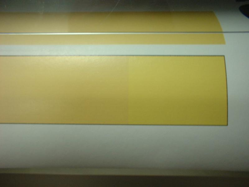

Hey All,
Have a problem. Just upgraded from 7.6 to 8.1. Alway had this problem but just printed from Roland VW except on certain colors. Anyway, I have a SC 545 EX Pro II V and when printing from flexi (8.1) it dumps so much ink that it literally pools on the sheet. Any ideas? Also, (only have the 545 for a short time) when printing a grad (white to 100% yellow) the LC LM is making a solid line in the print (when printing from VW). Any help would be greatly appreciated.
Thanks

Both of those would indicate a bad profile/ media configuration (no ink limiting). I would obtain a new Flexi profile (PTF file) for the ink and media and RIP that are being used in your shop, and install it into Production Manager (File Menu > Import Preset). THe PTF may be available from the web site of the manufacturer of the media, or possibly from SAi's web site.
Bob
