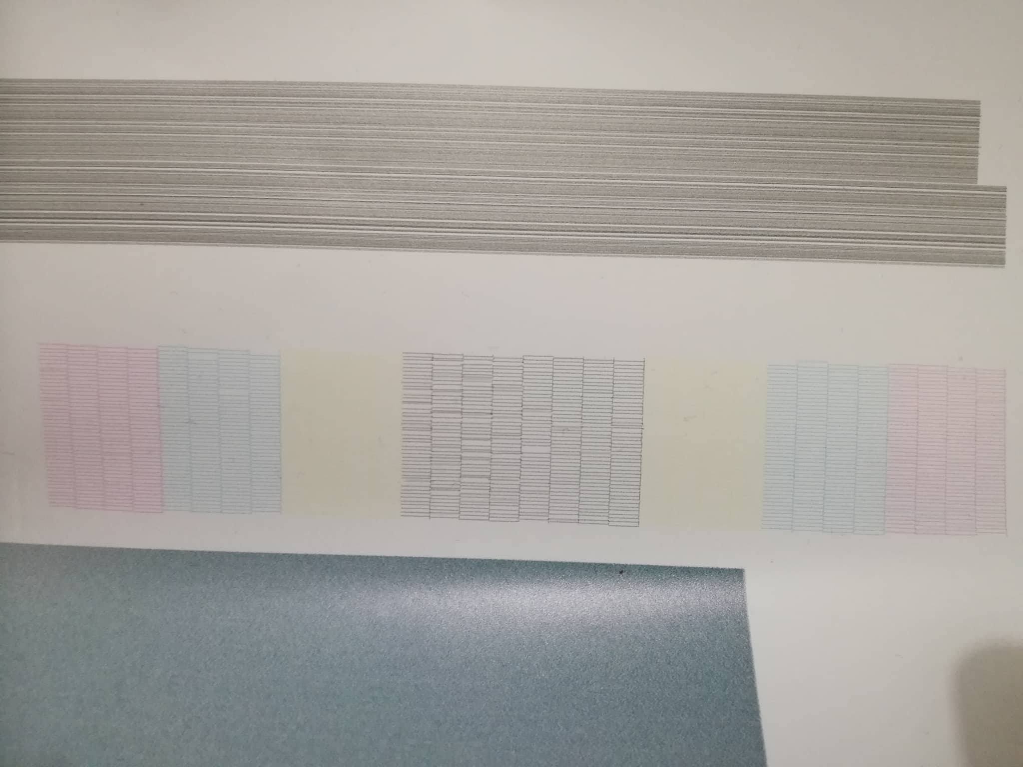

Hi. I am looking to buy a used mimaki cjv30-160bs. We aranged on price with seller, but when i saw the nozzle check, i backed up a little. PRinter prints good but i can see some banding, seller tells me i can get that with feed media comp fixed, but when nozzle check was printed i can see some nozzle defflection. Can anyone tell me if the is because of bad printhead (banding) is this printhead that bad or it can still print?

this is from the printer i would like to get.

Nozzle deflection is a result of many head strikes, I don't think these printheads will ever print better than this, probably the seller already did some serious cleanings before you saw it. On the other hand this test prints are not that bad, you can use it for a few more years. If you need better quality and don't mind long printing time you can always increase pass numbers.
OmegaAdv
You have only bad one channel of black.If you plan to change the all capping,pump and dumpers I think you will have better result. With that head I think have to print on 12passes without problem, but "feed media comp" can't hide banding, it have to be set to correct setting for different materials.
