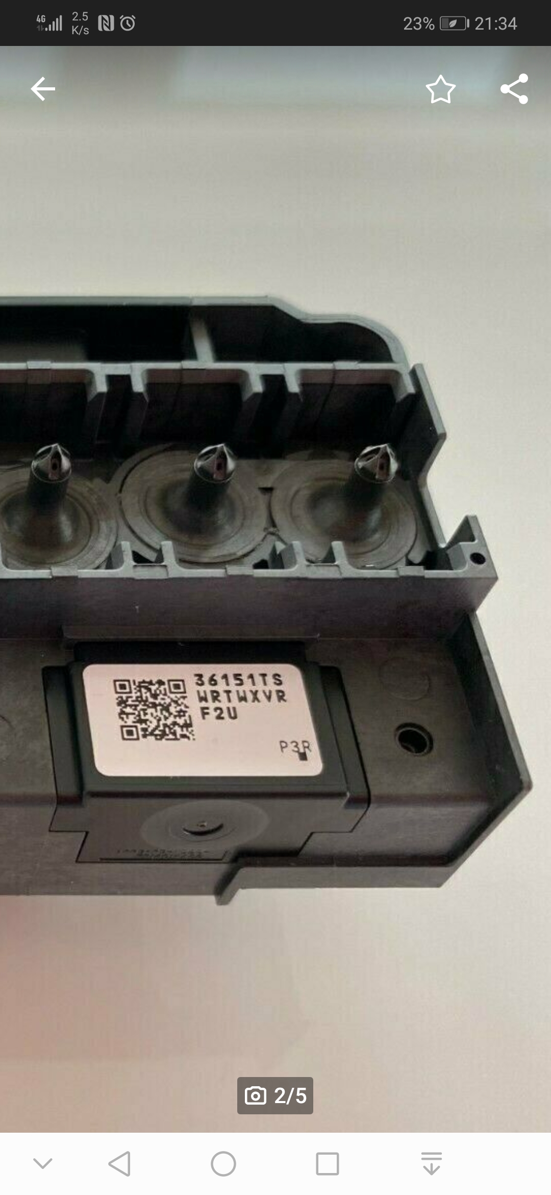

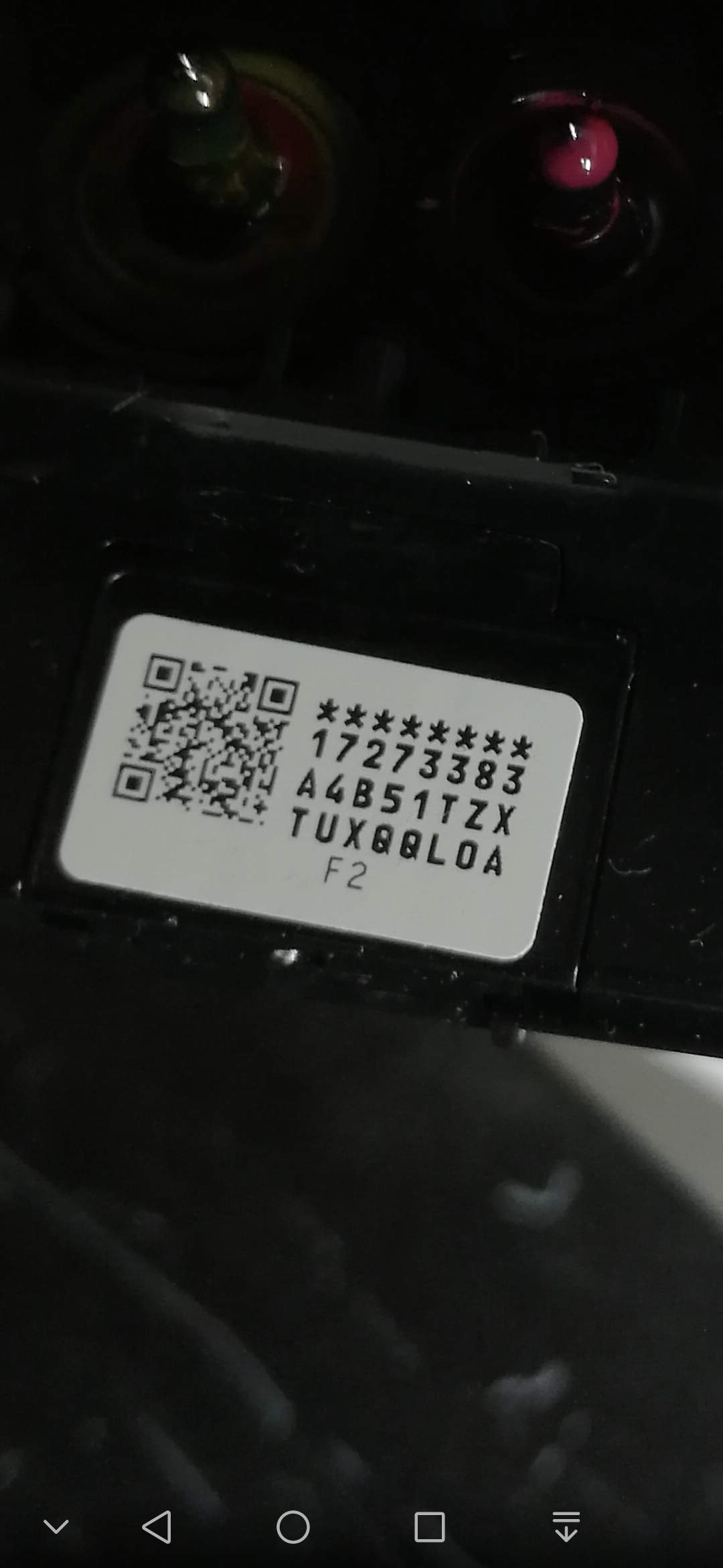

Does anyone know is this two printhead are compatiable for mutoh 1304 valuejet printer.
New one is
Epson DX5 printhead F187000 multicolor CMYK.unlocked
Second one is my used printhead.
Please check the images atached
Thanks a lot

Hi Igrajseti,
From my experience it is not compatible with vj-1304. Taking into account the price difference I'd rather buy a genuine one.

If I saw the complete picture I would know for sure, buy I believe you will see that the head to the left has a taller manifold. Also if the plastic manifold is more of a dark grey color, the original is a glossy black.
