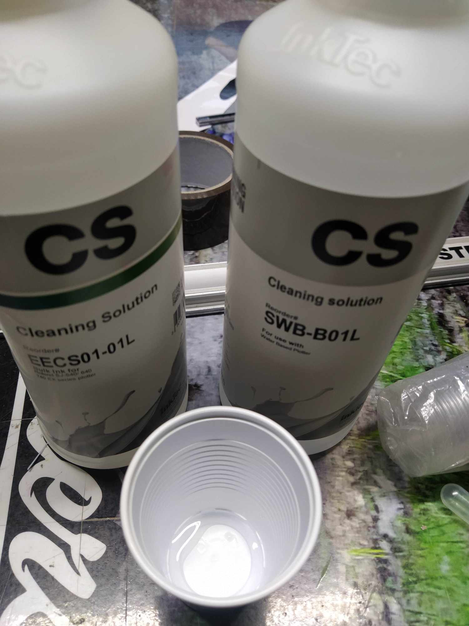

probull
I havent done it, but definitely don't put the head anywhere near an ultrasonic cleaner as it can destroy the delicate parts inside.
I don't see why you couldnt flush the head with the thinner until it is coming out completely clear, then refill with solvent ink.
Before doing that though I would experiment with mixing some of the thinner with some solvent ink just to see if there is any reaction between the two
Hi, thanks for reply. Yes I try now. The thinners are mixed, but I don't see any reaction there. I am waiting for answer Inktec.
