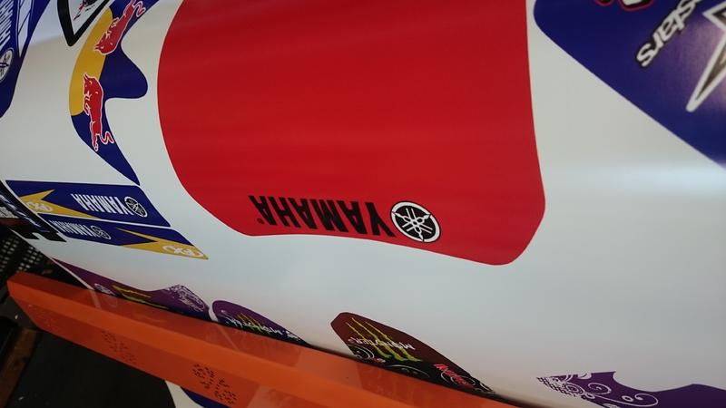

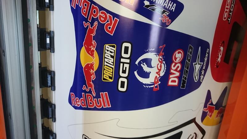

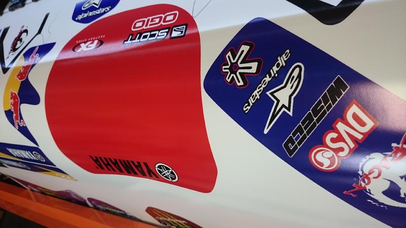

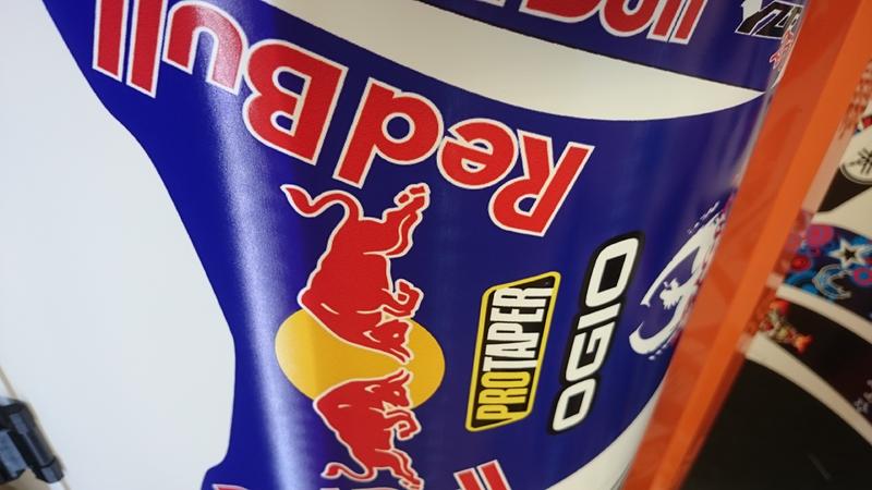

Hi Folks,
I have had this fault for quite a while now. It was only really noticeable on particular shades of blue but now it is over the fill range of colours and greys. It's as if the printhead isnt putting out enough of ink. It tends to happen on equal intervals such as 6.5cm apart.
When it was just the shades of blue, I ended up changing the ink tubes incase of blockages or kinks. The ink has been changed, dampers repeatedly, even tried to widen the holes in the manifold, though it is made from a bakealite type material and very brittle.
I am using a chinese machine that jailbreaks the coded printhead through its own software.
I am waiting on a second hand printhead arriving tomorrow which should hopefully help if it is a printhead problem.
Has anyone come across this before?
Thank you

I've only really had a bit of a botchup grounding cable, crocodile clip, copper wire and a 4" steel nail... any suggestions on a good grounding cable? Does this seem like ints not earthed properly? At present I have 68% room humidity and 21 degrees C
