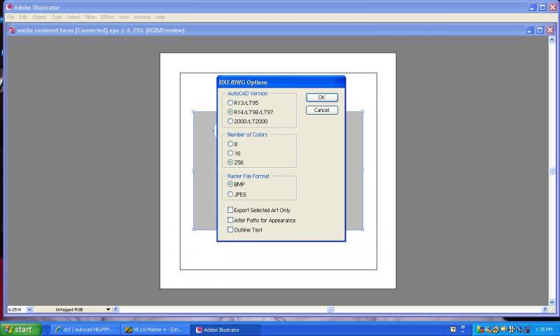

I've attempted to send an exported dxf file out of both flexi and Illy, to a fella running a waterjet cutter. It seems he can't open either file. At first he wanted me to resend it as a ver14. Then double check that things are converted to outline ect....nothing worked for him.
He tells me the file must be written in an "autocad" program seeing these exported dxf's aren't working for him.
Anyone give me some guidance or assistance?

skyhigh
flexi dosen't offer any options. Illy has these options posted in the jpg.
Illy does give me the option as saving as a DWG (autocad drawing) but the man asked for a DXF (autocad interchange file). I wonder if I sent him a DWG? Autocad people?
