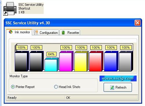

And a tip if you do get the nasty clogged tip then do the major cleaning cycles with regular ink rather than sublimation ink due to the cost...
I have 3 R1800's and fought with plugged I Q ink... The 2 in storage had head cleaner in the refillable cartridges but still dried up.
There is a waste storage tank and after you do so many cleaning cycles it shuts off your machine. I have a program that lets you Zero the counter. On the R1800 the 2 top switch LED flash. You should then add a external waste tank.
You Tube had some great videos on it... It is best to research the counter when you get a chance rather then on a Sunday when you have a order to go out.
