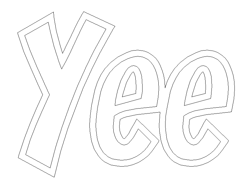

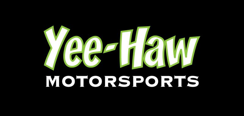

Well I'm new to this, and I can do quite a few things.. it's just sometimes new things come up and I'm confused.
The black is just a background.
I have the picture attached.. when I cut the vinyl out by color (green.. white.. the green is also cut on the inside.. and when I layer the vinyl.. you can still see the outline of the stroke..
What I want is a solid stroke (that isn't cut or anything).. and a solid outside layer..
Basically I want that stroke all the way green.. so there is no cut lines on the inside..
I just can't figure out how to do it!
Thanks.

What software are you using? I would imagine you just need to set your fill color to the same as your outline. Not that you asked for a critique but those two fonts sure don't seem to go together.

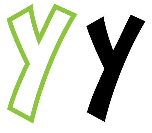

If I am understanding you correctly, you are layering the white over the green? I would just do the stroke and fill on the green the same, then it will only cut the outside line, and layer the white over it.
saktrnch
Clink on the Window tab in the menu, click on Pathfinder- that will open the pathfinder panel, click on the merge button.
If I understand this right and you are using Flexi when the outline tool is open in design central there is a little red box with a black line in it make sure you select the one with the center of the box closed. If the center of the box is open that's what you will get when you cut. I hope this helps. Sorry no screen shot as I am at home
Rick
What version of Illustrator?
Generally I would copy YEE-HAW
then the selected Yee-haw I would "EXPAND" or "EXPAND TRANSPARENCY" (depending on the type of stroke)
Then the lines shoulD all be vecTor, then go to "PATHFINDER" hit "ADD TO SHAPE AREA" and you should have a solid color backing.
then "PASTE IN FRONT"..
then go to "PATHFINDER" hit "SUBTRACT FROM SHAPE AREA" and you should have a solid letter to overlay on the backing.

When I merge.. it still cuts the inside line of the green. I'm using SignCut to cut also.

You also have stroke options like the stroke you have where the stroke id split between the inside and the outside, stroke on the outside, and stroke on the inside.
I like working in strokes because it is faster to get the effect I want, then get the file ready for production, many people prefer "OFFSET PATH" Using OFFSET PATH will still require some welding but yo will be working with real vectors.

ooops, before you add to shape areas, you may have to ungroup it....
