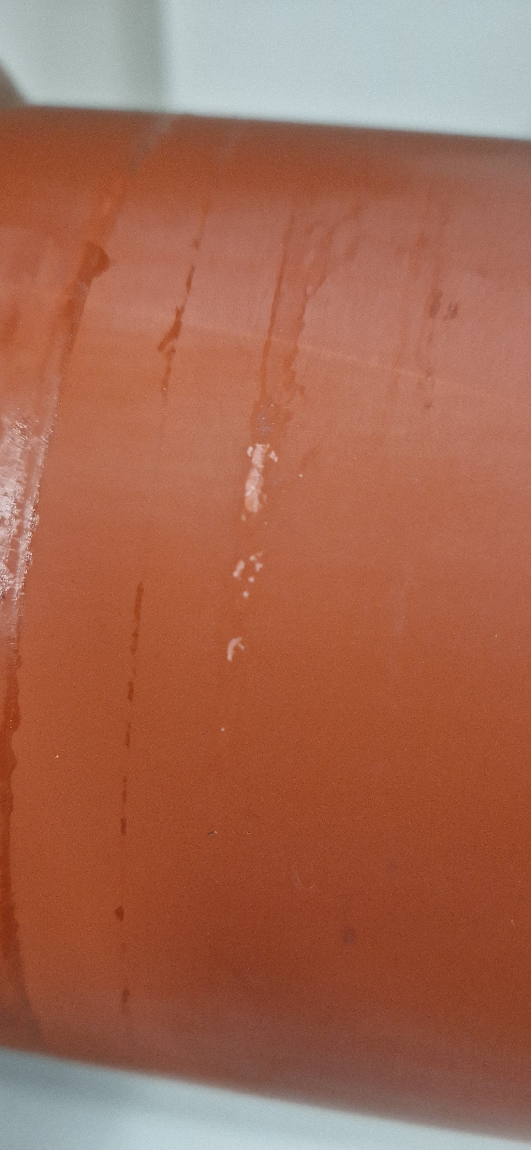

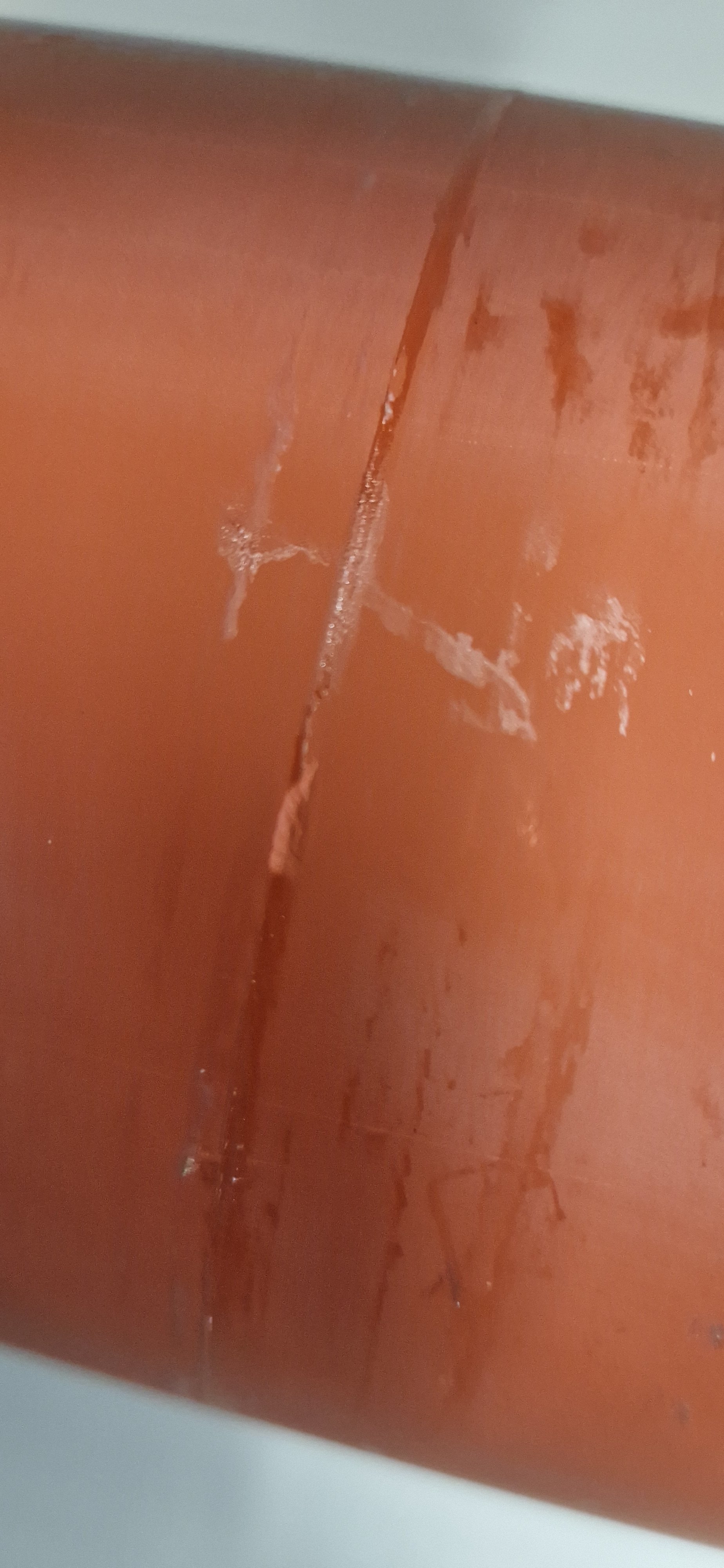

I've brought a used easymount laminator and thought it was mint. Now I've got it, on closer inspection there are slight chips in certain sections of the heated rubber roller along with glue marks in certain sections too.
Can anyone tell me I am I going to have problems with lamination due to the chips in the roller?
Is there a way to repair the chips on the rubber?
What's the best way to remove the glue and not damage the roller itself?
Many thanks in advance

You can have the rollers refurbished by a roller supplier, for example those who supply rubber rollers to offset printing machines, like Böttcher. That means taking the entire shaft out of your laminator and sending it away in a proper crate. If you don't want to spend all that money on it you can probably try a form of compressible material like Tek-7 or some other sort of "silicone-like" material, but be sure to "spackle" it so it just fills in the gap. If that does not stick to your roller, then you are probably out of luck.

Those rollers look very familiar. I have a chip in one of my rollers left of center. It creates a small bubble that I press out with my finger - and then it's 100% gone - yes, when I have an 8' section there's like 4 spots to press out - not a big deal.
The glue part, I would try and remove it with alcohol or something like that. Maybe do a test on the bottom roller to make sure it doesn't eat the rubber.
Can you switch the top and bottom roller?
Laminate a scrap piece, take a photo of the areas where the chip is and the glue, circle with a sharpie. Wait until the next day and see if those spots are gone. I have to believe the glue spots will disappear, the chip you may have to press with your finger. Going forward, press the chip bubble out immediately after laminating, I never wait until the next day.
It's just me doing the laminating and it's not every day I laminate so to press the bubble down is not a big deal.
Warm fingers for the touch down. Nitrile gloves helf prevent grease spots.

You can get the adhesive off of the rollers by heating them up and using an industrial rubber eraser. Back when we sold hot laminators, these 'erasers' were everywhere...I haven't needed to find one in forever,, but this looks like it would do the trick...I'd buy a few of them since they are cheap and if it falls apart you've got backups: https://www.amazon.com/iCRAFT-Adhes...icraft+adhesive+eraser+xl,aps,159&sr=8-3&th=1
The chips will likely show up. You can use high temperature silicon (go to an auto supply store) and slowly fill the cracks...of all things, use a straight razor blade to get the silicon perfect with the rest of the roller.
