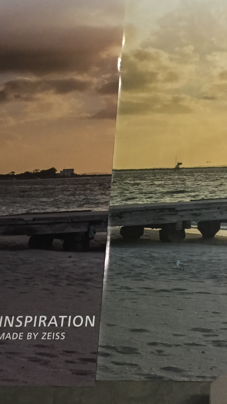

We have a jv33 and have run into something we never have before.
We printed a large wall print , split into 6 panels. We ran the rip and printed all six one after the other.. When we rolled it out 5 of the prints are perfect, 1 of the 6 is really dark/colour is off. The one which is wrong was first.
We re ripped and printed with the same result and have played around with the file settings.
What is happening is the yellow are very dark like mustard, when should be bright like a sunset. The black text is perfect and the browns are a bit off/dark also.
I presume this would be icc but what’s thrown me is all size files are saved on the same file, same settings and at the same time.
Any ideas???

That's really odd... and I have no idea why this happens. In the "color adjust" panel you can set -20% or -25% on magenta (middle) to correct the error, but I'd rather try to find the source of the problem in the first place. Did you made the sectioning in rasterlink or photoshop/illustrator?

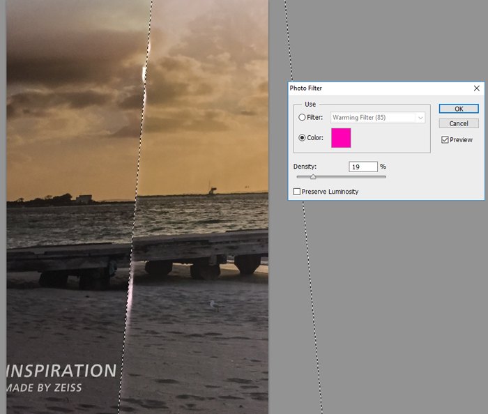

The colors are affected only by the magenta.

I’ll give It a go tomorrow. Just so I can get my head around this what your saying is that the darker print on the left has 20% more magenta than the right one?

Yep, the left one uses 20% more magenta, so you need to set -20% in the color adjust panel to compensate it. But yet again, I'd redo the slicing/saving/ripping from the beginning.

Can I ask what software you used in the picture you attached which allows you to scale the colour to test and match the other print?
