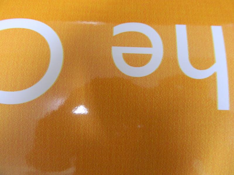

Ive just purchased a tjet1671c eco solvent printer. I'm still trying to get the printhead printing as it should but because of China's perfect timing on National holidays i was left hanging for the last week.
I'm having problems with the ink lying ontop of the ritrama 100 gloss finish vinyl and like a 'fish-eye' finish and as if it is not sticking to invisible swipe marks and cracks on the vinyl if i know what i mean.

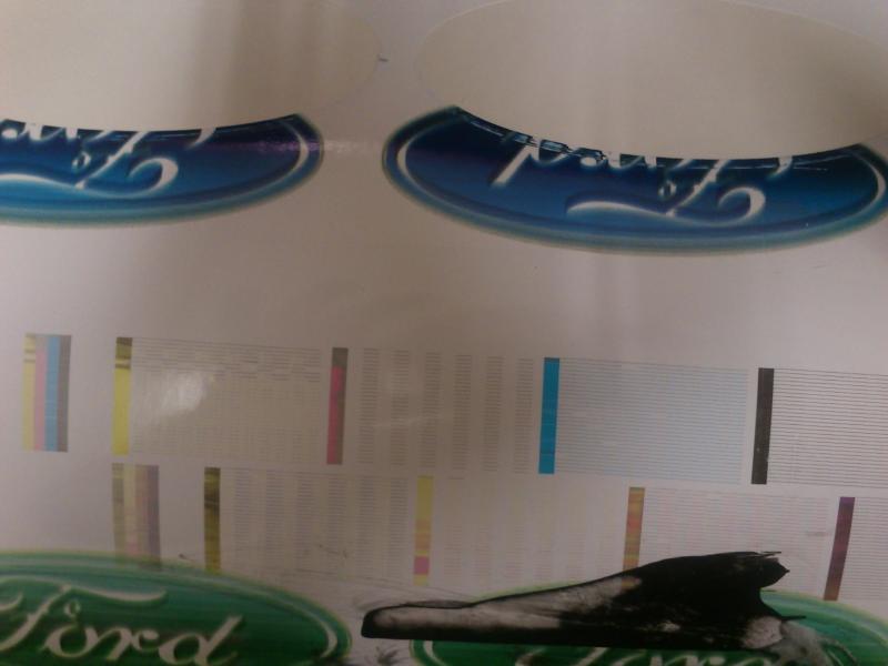

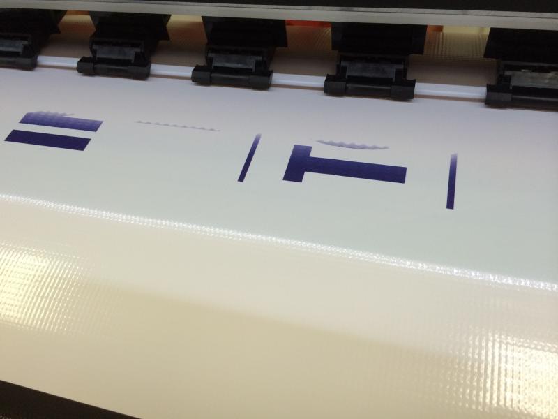

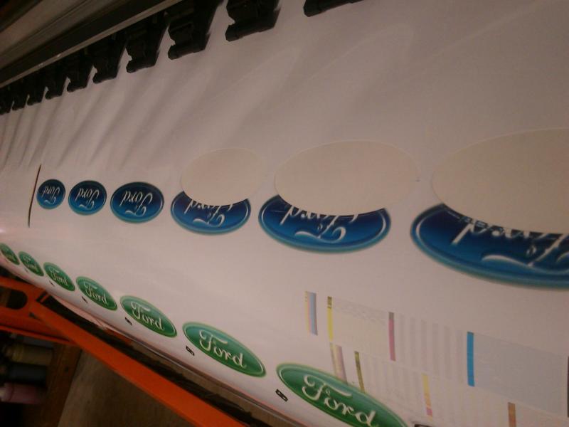

Now it's time to give in for tonight, another day away along with 1/2 litre of ink... I've attached my last 2 images for tonight, I took the head out and flushed it totally, adjusted the height of the carriage and angle but for the life of me I can't get the full magenta printing. The print and cut, i lined up 6 ford images on photoprint instead of increasing quantity on prod manager, flipped the image up side down... it cut 3, the start point was an inch away from me on the y axis and it looks like the x axis is gone to pot also, wonder does the feker reset itself?
I'm picturing me being bald with hairs growing on the palms of my hands at this rate. I'll be on to Sally before her school run in the morning and hopefully I'll hear back from her before the weekend.

Contamination
I cannot comment on the cut as I dont have any experience on that.

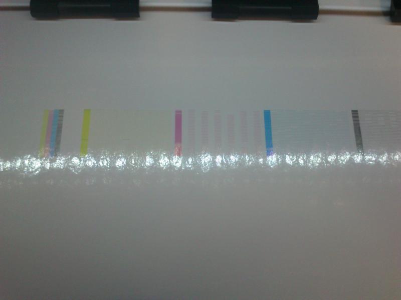

The print looks very bad.. you are having ink contamination. to check the seal of cap do this.
- Turn off the machine
- park the head sealing to the cap
- remove the hose from the bottom and put you syringe there..
- pull with gentle slow pressure not to break the head.
Ink should fill the syringe, if not and you hear hissing sound there is a leak and you need to fix the seal.
after that, print head cleaning and check that the drain lines are not clogged then print the nozzle check this should have no gaps on all lines.
is the magenta nozzle in the left most side? can you send photo of the capping station?
Curling
I also see that you material is curling.. whenever I print decals I put the heat on the lowest setting or turn it off at all.

you will never believe me but i think I'm almost there.... phew. Yeah, i had been working on the capping station to stop any air leaks with the syringe but the best way i got around it was actually to blow the ink back into the capping station until i seen where the ink came out.... hours upon hours and it seems grand but... guess what. My magenta won't print full, only half... Sally, the lovely lady that she is, said it could be either a main board fault or a head fault, she wont send me a board unless i try another dx7 head first... I shound have 1.2 a dozen kicking around...not, anyway through alot of playing around with the settings i have finally almost for the cut working as well, and yet again chinglish instructions are only good for a substitute once u run out of toilet paper.

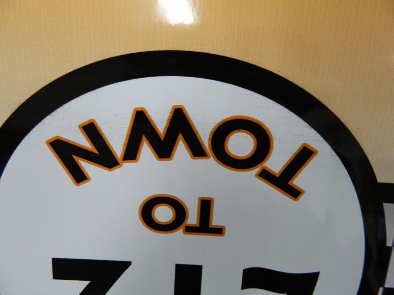

I have to say jsonpaul, thanks again for your advice.... what do u think for 1st run, a bit of 'overspray' if that is the right terminology on the white, printhead too high? ....and so it all begins :) the start of many problems :)
Printed this out earlier but this one gets a tad confused on the cut... maybe too much info but smaller repeat items cut out fine, off by about 1/2mm each way but nothing compared to my dealings with Sally.... every time I hear that najme I get shivers down my back now :) Have a good weekend

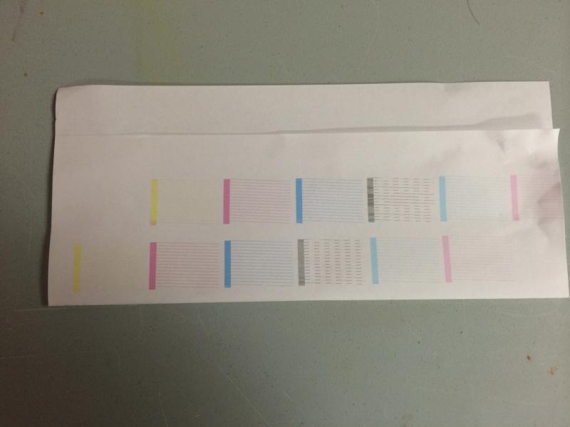

Photo of my issue before
I am glad to hear that all is getting better. I think need to sleep beside your printer lol.
Check the images, those are the results of nozzle check during the time when the capping station is not properly sealed.

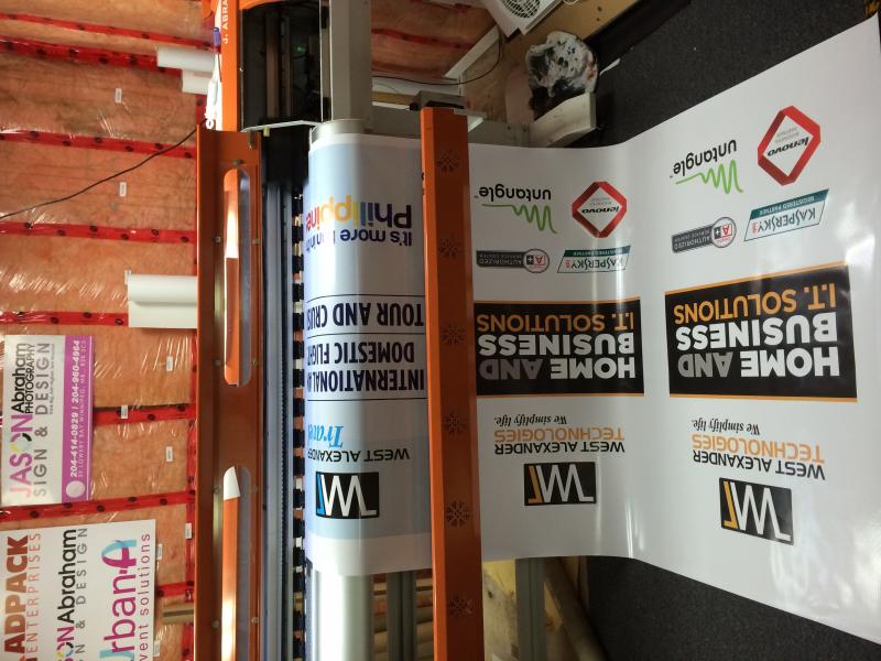

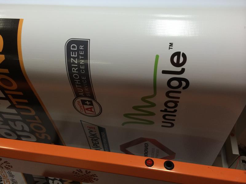

Sharing

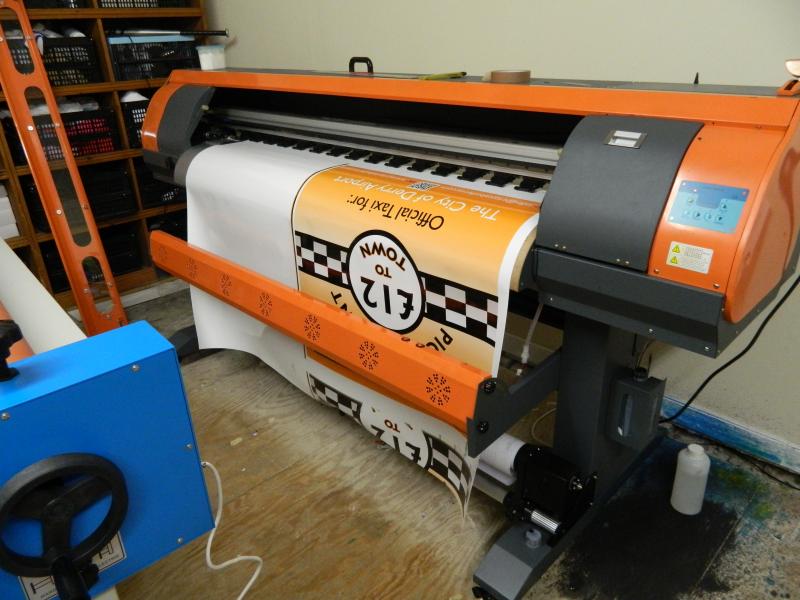

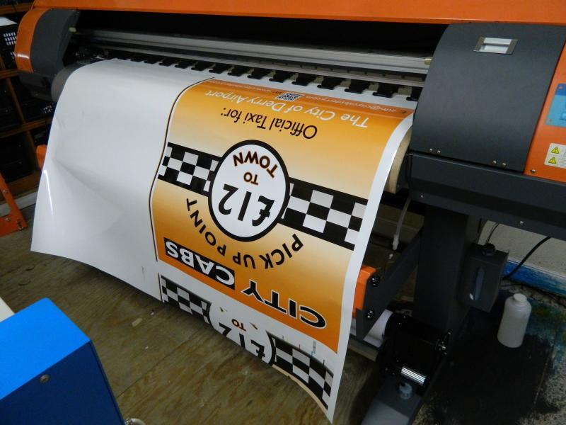

Just want to share what is on my printing plotter tonight. I always like the 8 pass although it is slower the print for its quality and sharpness... I know rolands, epsons and mutohs are better, but or my current clients this exceeds their expectations.

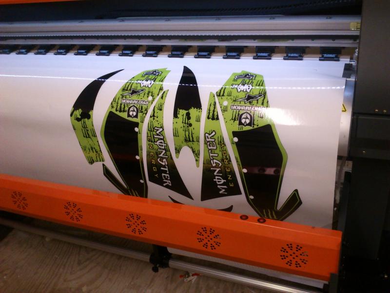

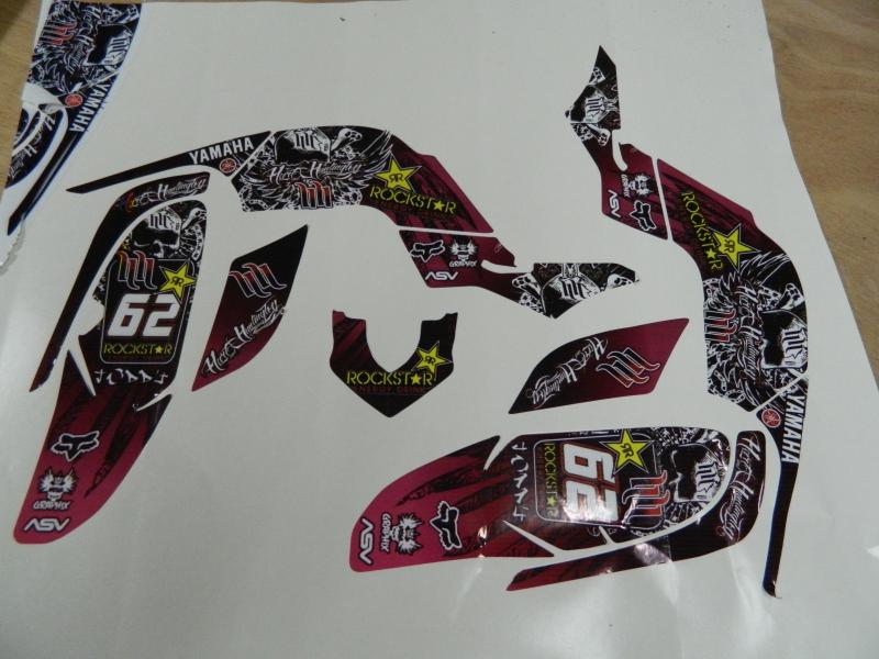

Hi Jsonpaul.
They're looking really well now, good job and crisp and clear, this is what i had been playing weith last night, the cutting is running about 1mm off but i can live with that but the black is 'overspraying' something fiece at times. It looks like there isnt enough of ink but then it sprays all over the place too. Someone stated that its a voltage adjustment thats needed but glad to be finally up and running to a certain degree. You'll see the overspray in the to town pic, the 'orange peel' in the orange and the cutting of the test quad graphics. Laminating today and running off my first print, laminate and cut decals today... woop woop lol

It is great to see that you are making progress. i am not sure why would it randomly spray inks. Is the distance of the media to the head is very close? the prints look great other than that random sprays.. or maybe the voltage in the machine that causes it.
I have never changed the voltage on my printer (this is an area that I have not explored yet).
