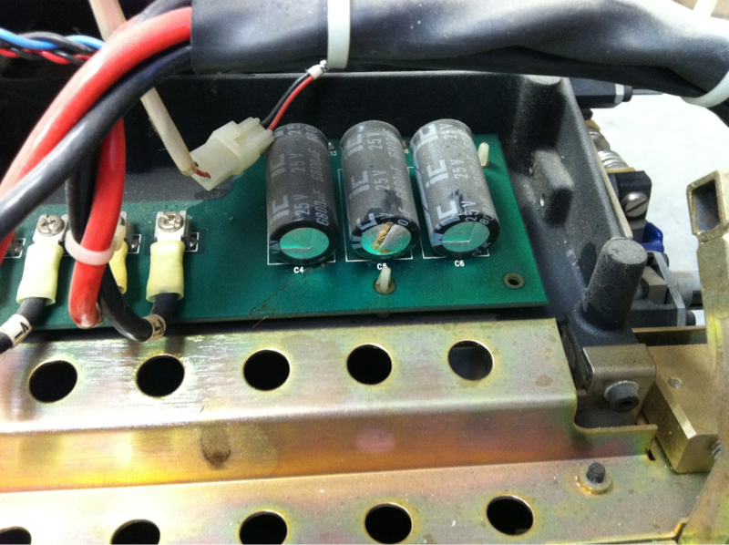

The day it stopped working completely, it was mid job and it suddenly stopped pulling the vinyl through. We turned it off and back on at which time something made a popping sound and a small puff of smoke came out. An electrician once told me that once you let the magic smoke out of something, it usually never works again. Upon further inspection, there are several battery shaped cylinders and one them appears to have slightly split open. I'll post a pic in a second.

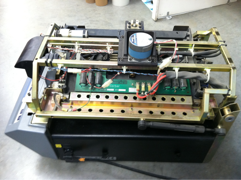

When I took the pics, I went ahead and turned the Edge on. It powers up fine and looks normal but it does give off a burning smell. The first photo is to give a frame of reference and the second photo shows the cylinder(middle one) that has slightly popped open.

Does it have to come from Gerber? Can I have it replaced locally?(it appears to soldered into place)
Any electronics repair can replace the capacitor with a new one. The question then will be ... was anything else damaged and did something else wrong cause the capacitor to fail? As things stand, you have very little to lose by seeing if simply replacing the capacitor will result in a complete repair.
SqueeGee
Right. No use changing the flat tire if the nails are still in the driveway.
