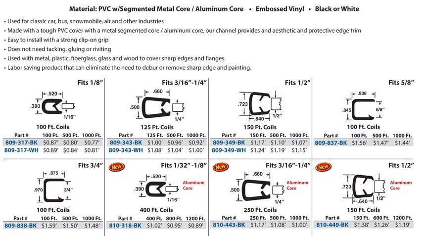

Hello, I have an alumalite oval sign and would like to put a white edge cap on it. I tried a semi-rigid PVC u-channel with some success but I'm not that happy with it - or my skills just aren't good enough with a heat gun? I found some edging from Outwater.com they told me would work. I'd like to know first hand from others what they use? I posted a pic of what they suggested, it comes in a coil... Thank you for any input!

Yes, looking for a a trim/edge cap that can be shaped around an oval sign measuring about 4'x8'.
Trim cap is a flexible product that comes in a variety of widths and colors that is used when making faces for channel letters, etc. Try calling your sign supply store or look online.
