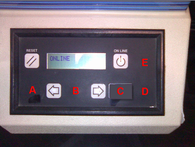

Howdy, keen to know if anybody here knows the sequence of keys required to print the internal test on a Classic?.. I can get it on my Edge2, however cant get the classic test print to fire up..

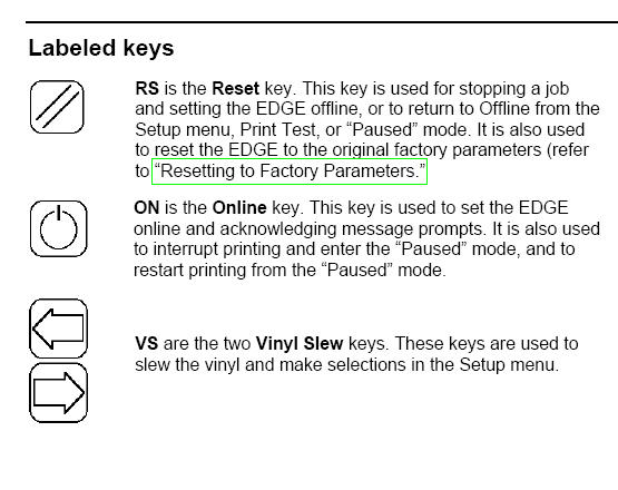

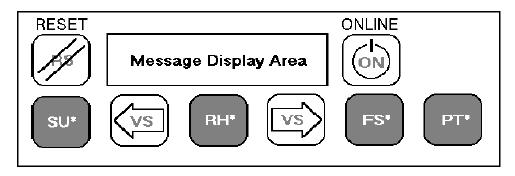

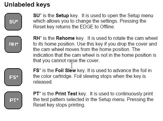

cool, found out some info off site, will plonk it here for others...
key board layout,
what they mean
unlabeled ones.
.. all you have to do is press the SU key a few times ans select the test pattern you want, then press the PT key..
