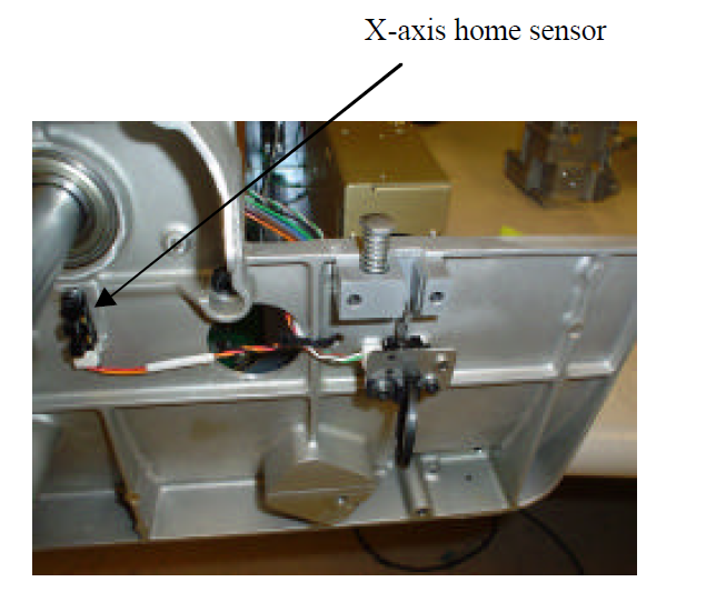

sounds like your home sensor isnt working or is dirty - hidden behind the front panel - I have an image of it somewhere
Jburns
signage
quick question when you hit home does it go to the home position? If yes them I would think the home position sensor is working, if not them try cleaning it, or replace it
