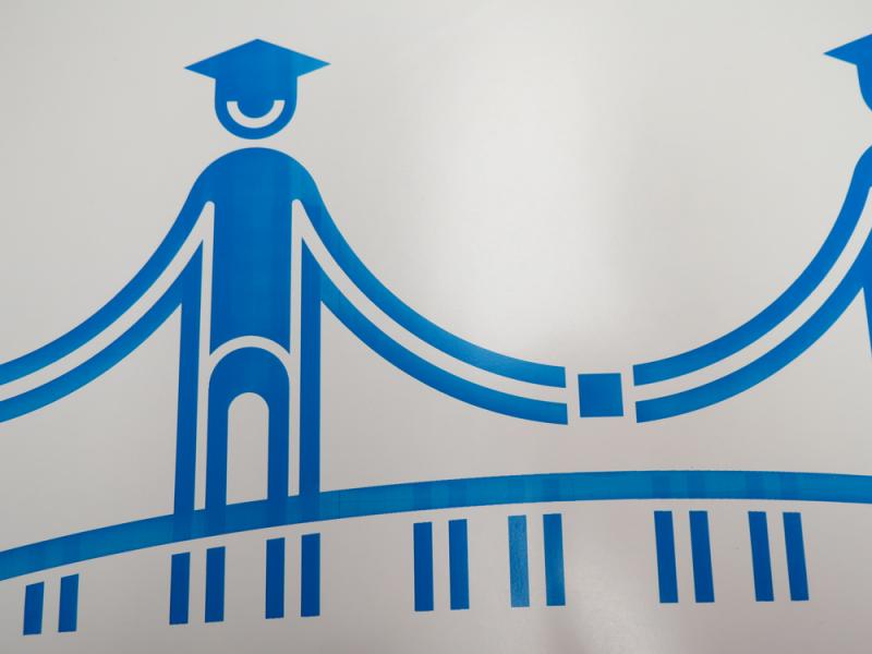

Trying to print a solid light blue onto the material. No gradient. Those were the two colors of light blue I have in stock in foils and both are a close mtch to their blue. They have 6 different color themed drapes that all printed fine onto the material; black, dark blue, orange, purple, teal, etc - it's just light blue that's giving me troubles. tried printing both light blues onto other material (220 white) with no problems; back to the Siser & they are all "banding". Pic coming soon.

Here is a photo showing the banding I am describing. The banding is linear with the material. Tony, I am also emailing you the original high-res photo.

Tony Teveris
It really looks like a material / foil combo that does not play nice. The darker areas look like they are "over transfered" but its hard to tell. Also the darker areas are where there is more foil along the head being transfered so at that point in time there is more "heat" to the head. Take some scotch take and put in on the dark areas then ripe it off, if anything is on the tape then it points to over transfer.

Turning the heat up to "high heat" in the "123" dialog in the output window fixed this problem to an acceptable level.
I will try the tap trick to see if anything pulls up, but the solid areas are the correct saturation/opacity desired; the lighter areas are the incorrect areas.
