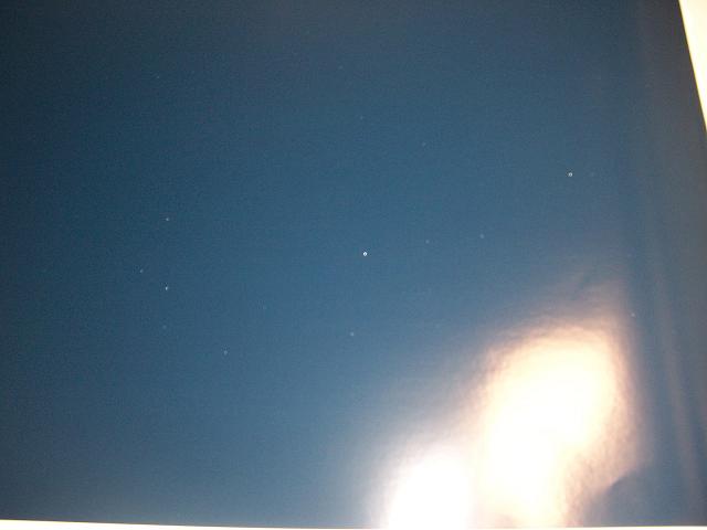

Was wondering if anyone could tell me if this is correct or incorrect. I have purchsed a used Edge Ii and have ran a test print. I ran a solid test and am seeing white dots scattered randomly. Do I need to clean the head?

You need to clean the head regularly anyway, That's just dust. Lack of head cleaning will leave horizontal lines that are quite obvious There is a hidden key for a test print to the left of the setup

Head cleaning should only be done with 99% to pure isopropanol. Diluted alcohols have water in them which will cause corrosion. You can buy special cleaning cards which are presoaked from Gerber or you can just buy a jug of isopropanol.
The dropouts you are seeing could be coming from poorly prepared or contaminated vinyl. Are you using 3M vinyl for your test? There is also an idiosyncrasy with the Edge to print dropouts when it is first used for the day. many users have gotten in the habit of running a few inches of waste printing to start the day.

My edge came with cleaning pads with some type of alcohol on it. these worked great.
make sure your little brushes that rub the incoming vinyl are in good shape too. they will catch a lot of stuff.

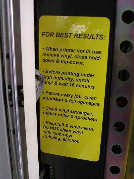

Printing on 651 using Duracoat ribbons. I have cleaned the head with one of the cleaning packets that come with the ribbons. Should I wipe the 651 down with 99% as opposed to 70% Isopropal.

In ten years of running an Edge, I have never wiped my vinyl down before printing ... with or without a solvent. I often use exactly the same combination of film and foil that you are using.
Where did you get the idea that you need to clean the vinyl?
