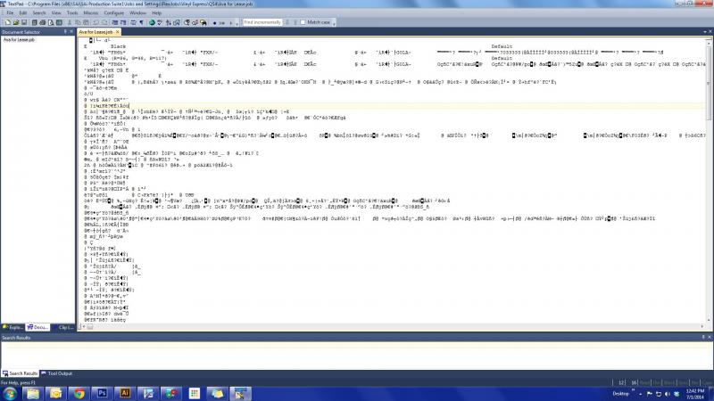

sample of a .job plotter file, opened in Textpad...

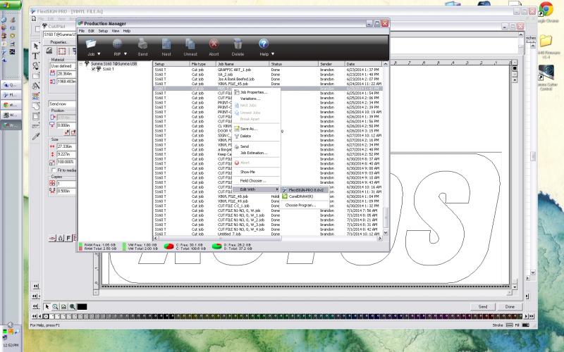

eahicks
Hmm..mine gives me no options. I have to go and select whatever program I think I should use.
eahicks
And it makes sense it would not work, since .job is not a file type that Flexi can open or import, if you scroll through the list of types. Production Manager, however, will open them, as it is the actual program that creates a .job file from the info sent from Flexi.
