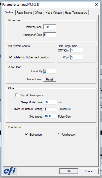

Superior_Adam
Its in the main settings right in the middle called Auto Clean. Just remember when done to turn it back to zero as it keeps track from job to job. On full rolls just make sure your material is in and tracking straight or you will get material starting to tunnel. I bypass the media roll holders I just let the material sit on the bar and use the ends to hold the material in straight and dont have any issues running full rolls.
