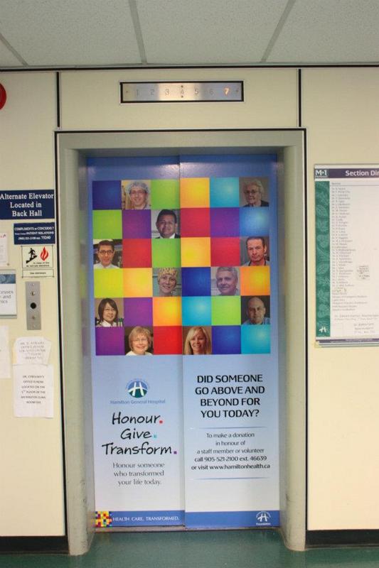

We have done a ton of them as well. One example was in a major hospital, did the outside of the doors on each floor for 4 elevators on 10 floors. Yes - you need a key to stop the elevator at the door you are working on as mentioned. On this particular hospital one this was the main front "public" facing elevators which are not used by hospital staff for gurneys, cleaning carts, maintenance stuff so we used gloss laminated 3M 180CV3. 6 years later and they are all still up and all still look great for the most part. Been a couple of small dings but really no problems at all.

We did about 15 for a local hospital about 4 years ago, printed on AutoMark, laminated with a 2 mil semigloss laminate, they are still holding up great, they are a bit banged up from the gourneys and wheelchairs on the bottom, but not too bad, there was some vandalism on one of the doors in an "inner city" hospital.
If you are quoting the job, dont forget to account for all the time d**king around to get the elevator shut down. We found it was taking about 30 minutes per elevator to have the maintenance guy find the right key and lock it down properly, install was only about 15 minutes after that.
