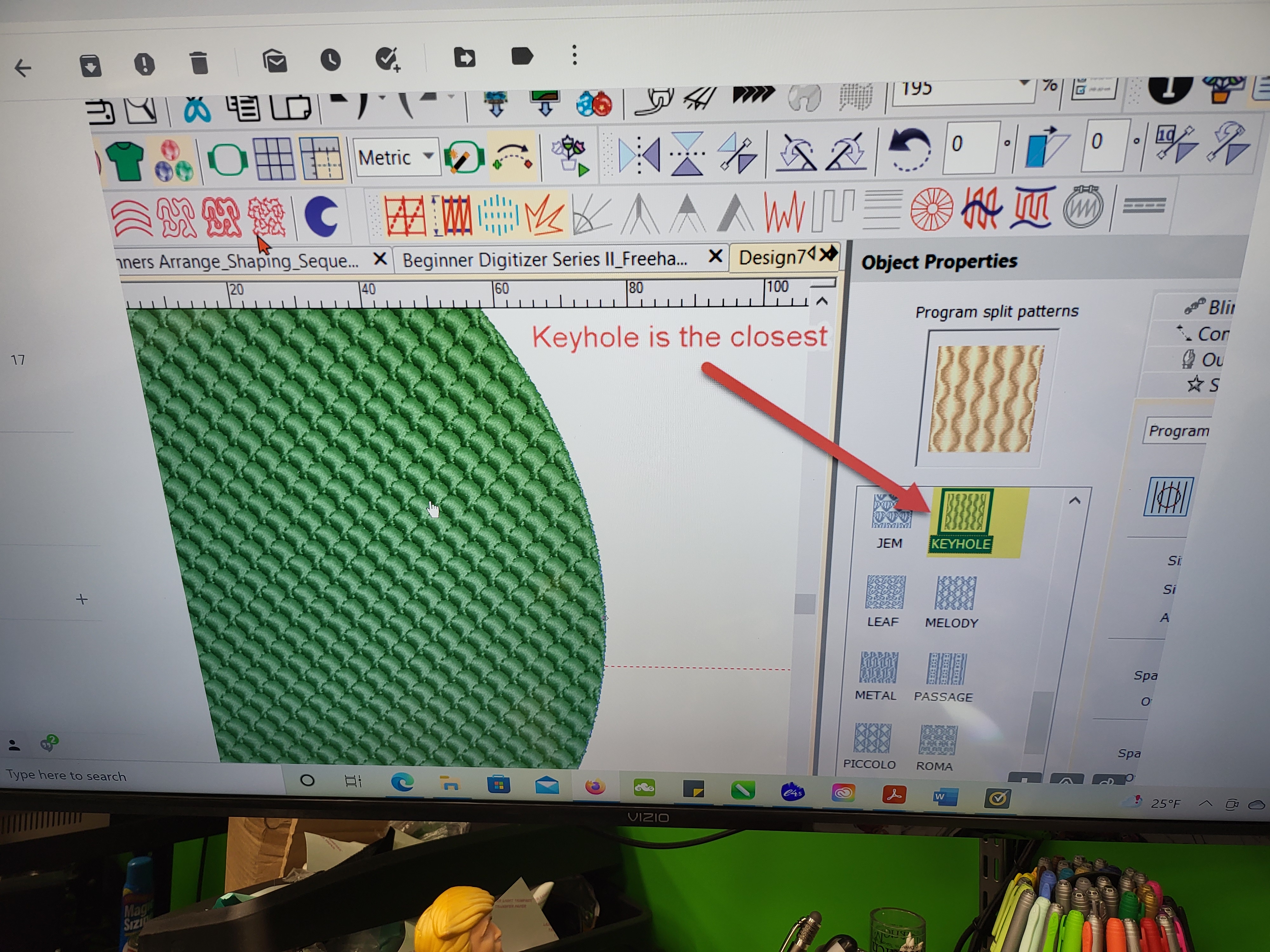

Wilcom send me this then I asked if that's the custom split element he said no lol think he meant sports patterns.
WildWestDesigns
Yea, if it was a custom split, it would be (if I recall correctly) an ESA format (it's the same format that is used for their digitized fonts, proper fonts, not auto converted TTF/OTF fonts(stay away from using the auto converted stuff), it's essentially what I consider to be an outline format) and that would have to be put in a specific folder for the program to know what to do with it (same with the fonts). If you get custom ones or you create custom ones, make sure to copy and post those custom ones in a backup location as well.
Is there a picture of something similar of a design that you are wanting to do (in case you don't want to show the exact design).
