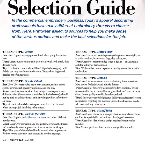

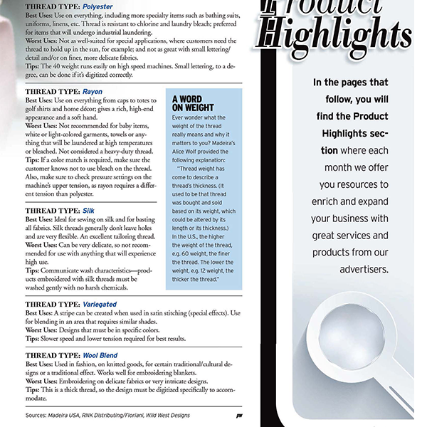

For those that are interested in the different types of embroidery threads, their usage pros and cons, as well as, some tips in their application, there is a little thread selection chart in this month's issue in Printwear that I had contributed on.
I've just attached pictures of the chart itself, if you want the rest of the article it is on their website for online viewing/downloading as well.
