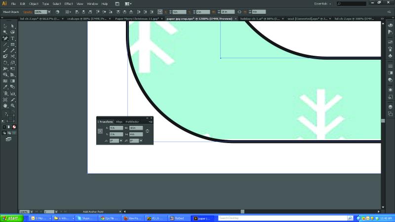

I have attached the image so you can see it...I have to move the blue graphic area down a bit along with the text just so it will print correctly on my sign

bgraphics
I would check your origin on the flatbed... could it be off? Also, when something goes wrong with an .eps or .pdf, I turn it into a HQ jpeg... that solves all problems.

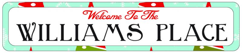

I have attached an image and i see nothing outside the box when i select all the sign blank is 4x18 and the image is 4x18

John Butto
Even if you select all and it does not show the clipping mask with the artboard, it is still there. Go to Preview/outline and then you might see it as it will print.
