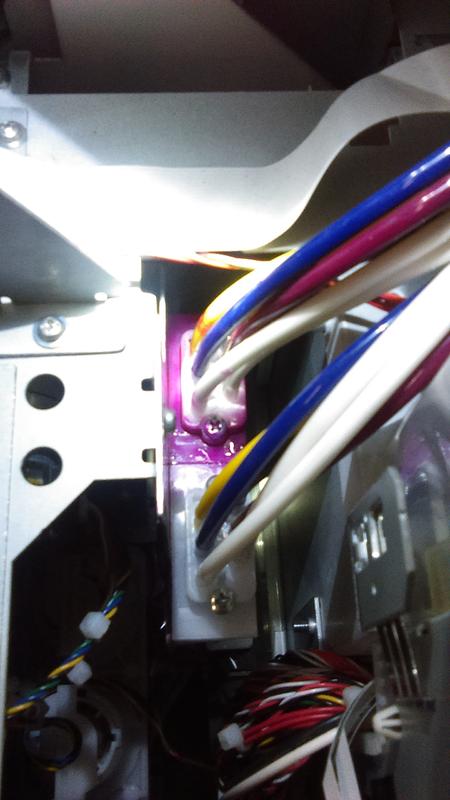

I'm pretty sure there is an o-ring under this manifold / block, I just would like to know what might happen if I pull this part as is. Should I flush the ink lines, then pull and replace the o ring? Will I introduce air into the lines while doing this? If so, what needs to be done to bleed the lines?
As of right now it is putting ink down the printer onto the floor, and I'm concerned that it's going to eat up other parts inside the printer before I can get it fixed. Anyone have a source for replacement parts?

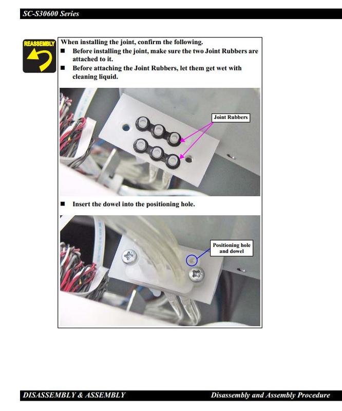

I found it in the 30670 manual. I think ink will run everywhere. Nothing new from what it looks like. Personally I would flush and have rags ready. Mind you I am not a tec. When they came out and did my printer head they used a syringe to purge the line before reattaching to the print head.

here is the part number in the UK, I don't have the one for US. You need number 529
