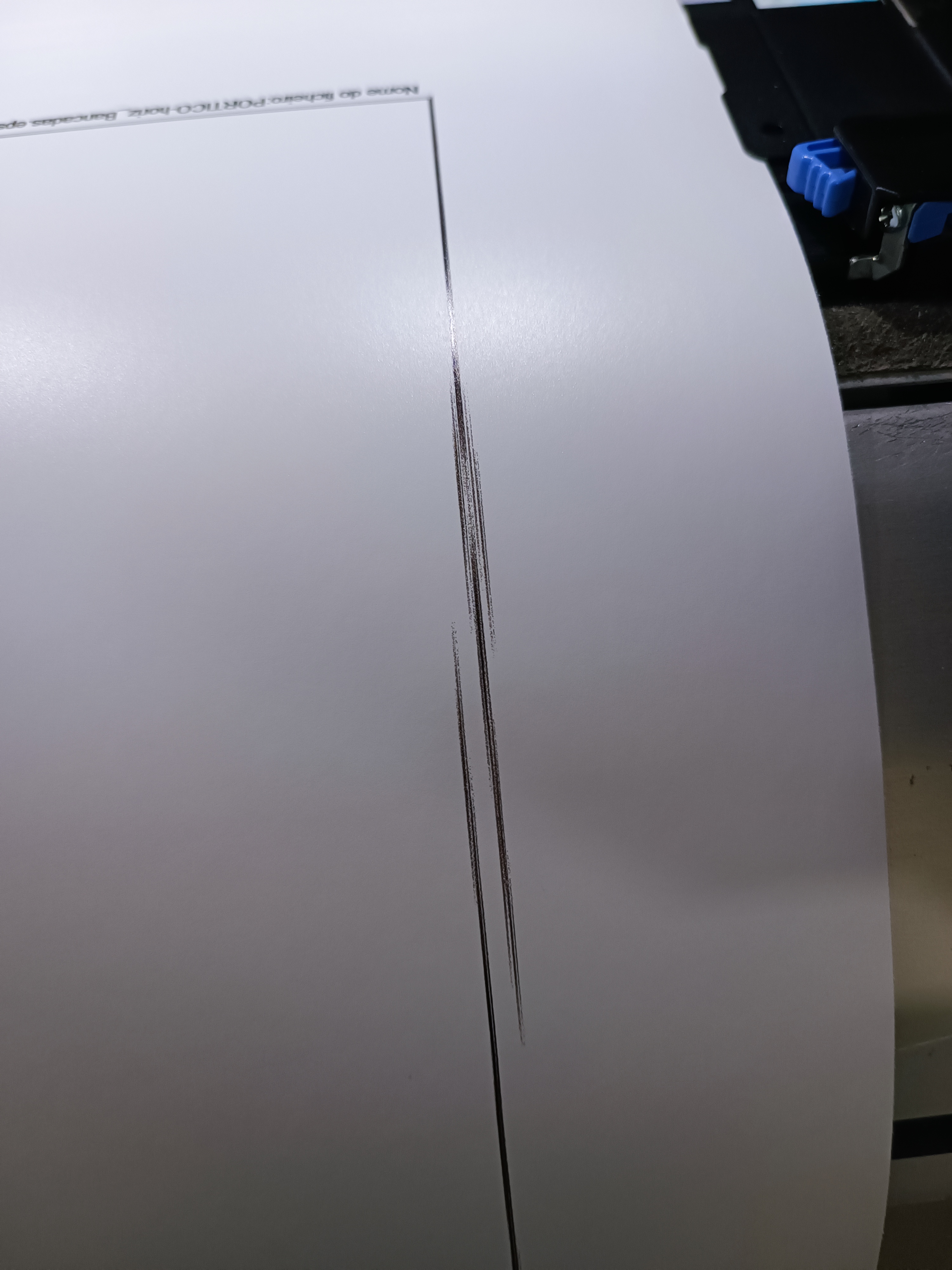

Hello guys, I'm having some situation with a 60600 in the end of the job makes a misalignment and then an 150c error. Anyone can help me?
Thanks
SignMeUpGraphics
Super Active Member
150C is a planetary gear sensor error. This sits under the CR unit (carriage where the heads are attached).
I'd suggest a service call for this one as there is a lot of work involved.
