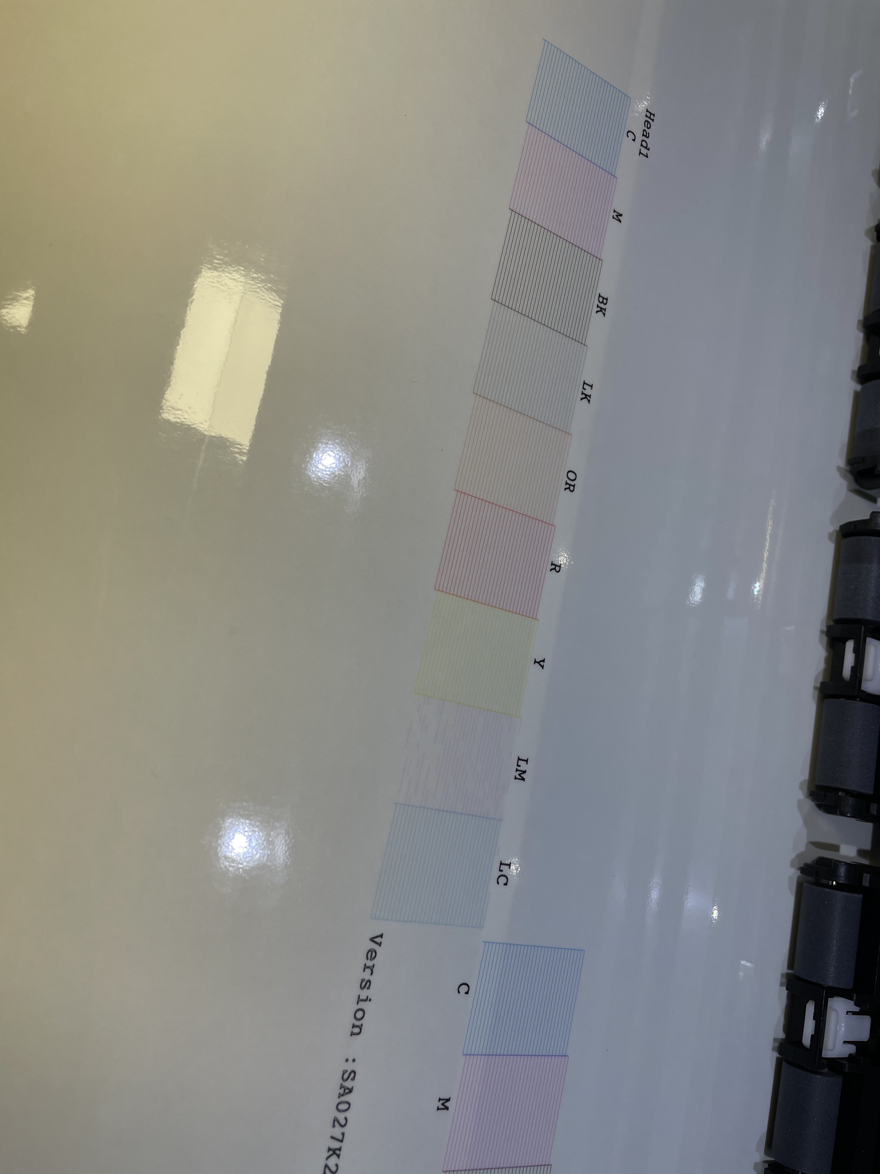

Hi. I have a problem with LM only on head 1. All the sudden the pattern began uncomplete (pic). I did several manual head cleanings, and few light, medium and heavy nozzle cleanings on LM/LC channel.
Nothing really changed except little difference in those patterns.
Didn’t try head wash option for LM/LC yet.
Any suggestion?

PhantomSteve
In my experience, the head is starting to go.
Which means a head replacement.
How old is the printer?
We have a 40600 and we are about to install our 4th print head in 5 years — which is really bad — but South Africa's crap electricity supply is probably partially to blame as the printer only works about 4 hours a day if averaged out.
Sometimes you get lucky, sometimes you don't.

Agreed.
Lifetime cycle is the head is about 20k.sqm or 1.5y

Printer is approx. 3 years old (17.1.2020), 6.600 sqm if LFP accounting tool is corect.
Till now everything works perfect, 100% nozzle check. This happend from nothing.

Had absolutely the same situation recently in my 30610. Lost one C and one M within two weeks so replaced the head in the end.

That's how a head failure looks.
Perfect — then a blocked nozzle — then 2 or 3 — then more (especially if the same nozzles remain blocked).
And you think it can't be the head — you hope it's not the head.
You look for other solutions — you find people who say it isn't the head.
You are hopeful.
You try everything.
And in the end, it is the head — and all you've done is waste your time and print production time.
I've been there — many times.
