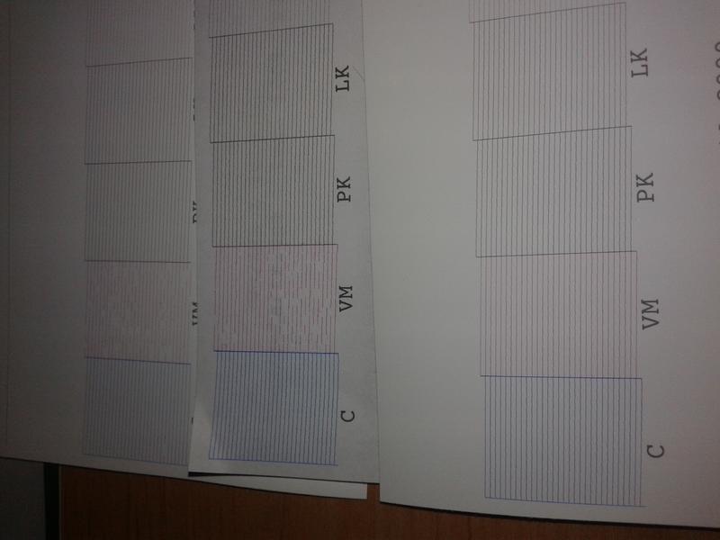

I own a Epson 9890 which works great hmmm
I always get a clean nozzle check but it don't start this way, Its the VM Channel.
within 24hrs ink is drawling back out of the head and if left longer it will take stronger cleanings get air out of head.
There is no clogging, I Changed the damper unit when I installed my none oem inks and do daily cleanings.
The refill system works great. I thought that this was the issue on VM channel so I ordered a different brand cartridge.
Still an issue.
I believe in my head the ink bay area possibly is the issue tin foil slow leak etc.
all heads beside that vm will stay primed.
Any Advice.

Updates
Ok so it comes down to a cleaning every two days max. I uploaded the firm ware give me individual powerclean on groups but haven't needed it. Just keep pumping
