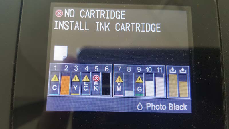

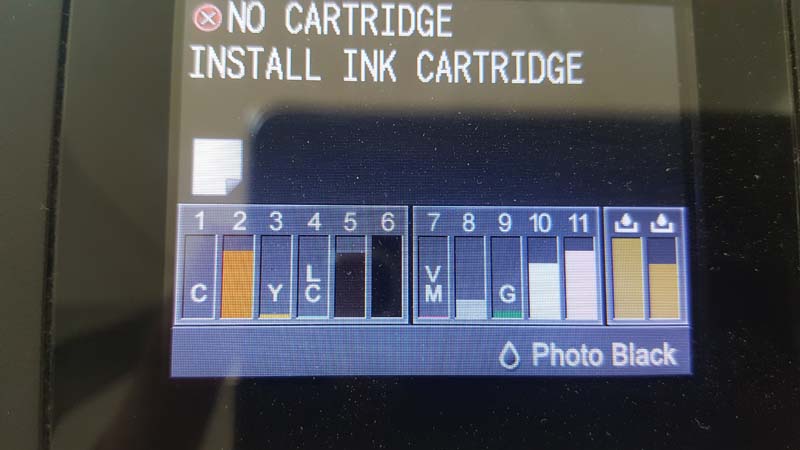

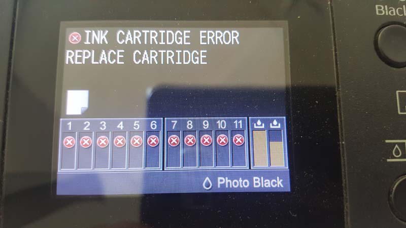

I got an ink cartridge error on all 11 cartridges. if pull out 1 cartridge all other inks show up fine. it doesn't matter what ink i pull out to make it do this either. any ideas on what could be going on here?

Anybody ever solve this? Ive exhausted every avenue. I have 2 9900's and they are both doing the same 11 ink error. my second one turned on ok and it was fine until I went into service mode to do initial ink fill. After that It also gave me the ink cartridge error on all 11 inks. If you pull any ink cart out it reads the rest correctly. I tried all new refillable ink carts. I updated the firmware no luck. In service mode i get the 1439 error message on both units. Ink system/pump station may need replacement but would that not permit the printer from reading carts. Really need one of these printers working and Im out of ideas.

Ive had the carts out dozen times. Ive tried everything. One printer to the second, always red x's unless I pull single cart out then the rest read ok. Any cart out rest read good.
