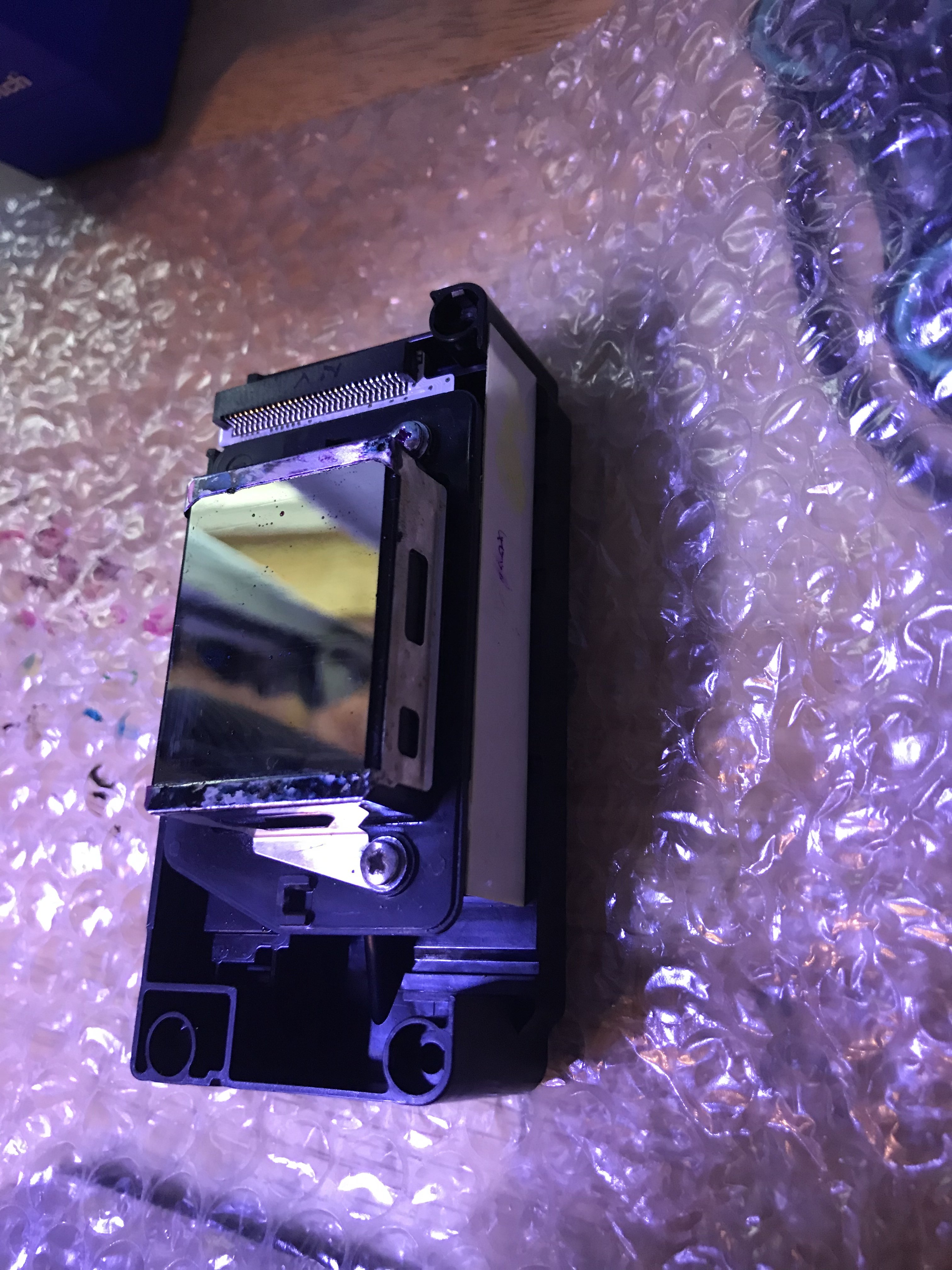

Epson Dx5 in valuejet
midnightmadman
This is the head

It depends on whether or not the DX5 head is locked or not. Older heads are usually not locked. Newer heads are.

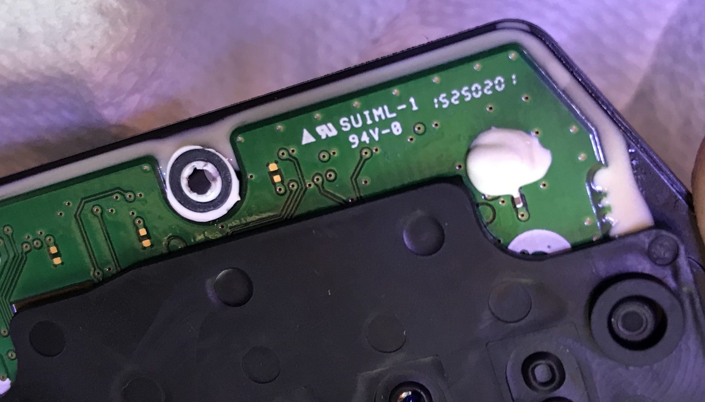

the r with 4 digits following model of that huge printer firm is basically a 17 inch wide printer so they need to not equip the head with squirty power after that, so they put a bit of elecrickery magic on the head under the potting shmoo to make the head do exactly what it is doing in yours, the non oem cards simply reverse this .
but from the green x5 which was open they had first gen Teflon open, second gen first lock, 3rd gen second lock
so you will need to buy both cards
