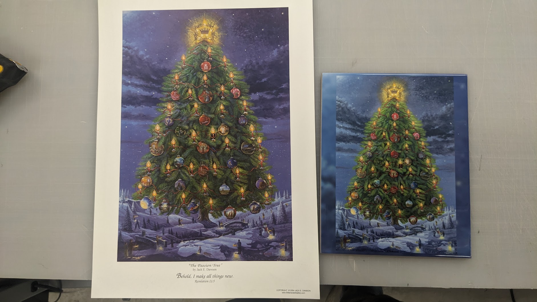

We sublimate onto coated ceramic tiles and, since we switched tile manufacturers, the color has shifted and is too yellow with not enough contrast. We are using Epson edge print that came with the F570 and I cannot find any way to edit the color profiles in this RIP software. Has anyone been able to do this for sublimation in Edge Print? Open to suggestions on how to fix this issue. Fairly confident it isn't an issue with press time, paper, or heat.
Left pic is the reference and right pic is the current output. (I couldn't find our tile reference)

Although you don't think it is the heat press settings, I would go there first. Different manufacturer, different tile.
You could also do saturation and contrast adjustments in Photoshop or whatever software you use. I have found that sometimes the file format prints differently on different substrates. Sometimes PNGs come out bolder. Also try changing the printing color space. I use relative columetric for cymk files but perceptual for rgb files..
