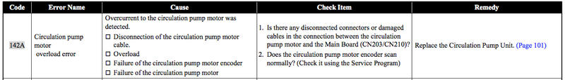

Our Epson S70670 has been giving us random errors between prints which cause us to have to reboot the machine to get it printing again.
It says "Circuit Error 142A" (call technician for service, or something similar), but rebooting makes it go away for a day or so, but it is happening more frequently.
I called Epson a few days ago and they said they were going to call me back with what is causing the error, but I haven't heard back from them yet.
Any ideas?
mpn
Circulation pump motor overload error.
