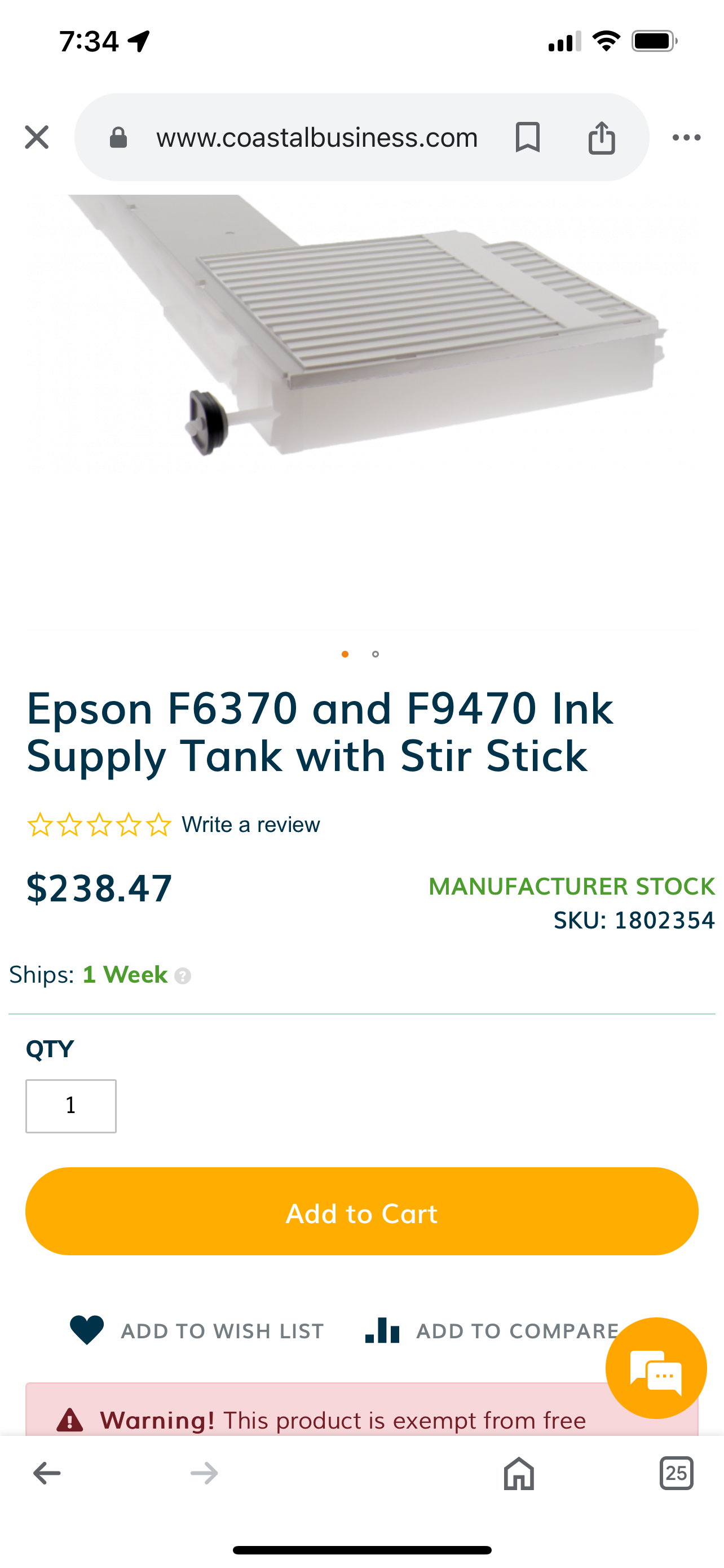

You have to replace the whole tank to get the stir sticks added. It was $300 to replace them. It's not too hard to do. Before that we would stick a mini stir stick in there on a drill.... it's just messy to do that so we got new tanks for all of them.

Margrit
Margrit
This is what I found. You must have drained all the ink before replacing the tank

I feel epson should have put those tanks in all their F6370 if they knew this could be a problem. I also have chemical machines( wet Lab) and the chemicals are constantly stired by pumps, and that brings up another question should the cartridges for my other inkjet printer taking out periodically and gently shaking to prevent settling.
