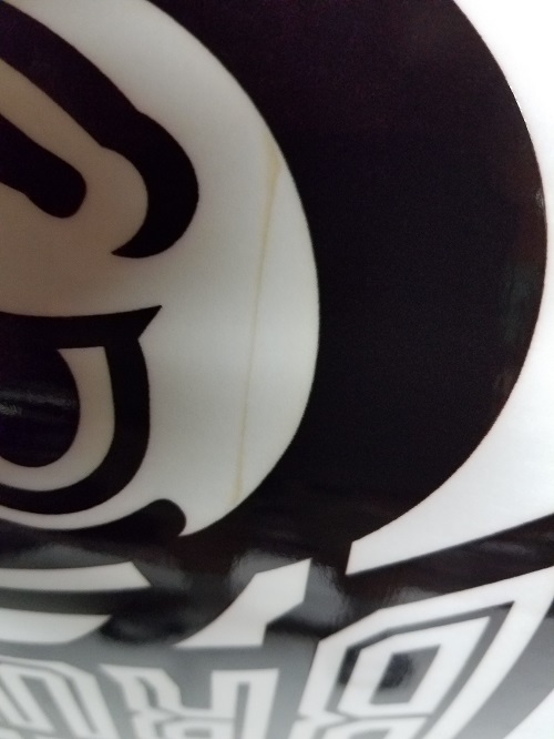

Hello all,
Anyone know what would cause this, I am getting ink bleeds on large prints, see attached
Could this be a wiper problem?
Thanks in advance..

You talking about the little blue streaks? Are they in the same area every time? Try cleaning the encoder strip. Could (more likely) be the ribbon cable from the print carriage board to the mainboard - pain in the glutes to replace

Thanks for the reply, no Its not on every print or the same spot every time, just seems to be on large prints,
I will try cleaning the encoder strip, this is on a GS6000

I've only worked with Roland's but assuming most printers work the same I'd bet on something electrical with the cable to the printhead or board that controls the printhead.

Just tried a few more prints after cleaning the carriage, encoder strip, dampers and replacing the wiper and flushing pad,and its still doing it ..

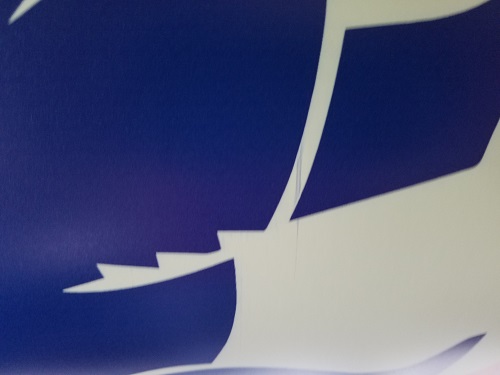

Just printed a couple more prints and now its not a smear its a fine line in the print where the white should be
