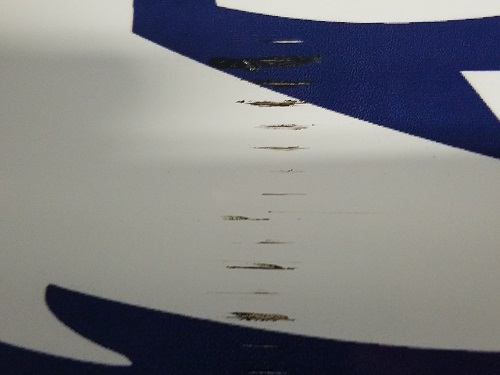

Anyone know why this printer is leaving these marks in the middle of my prints, Its not on every print, but it seems like its on the first print after it sits for more than a couple hours. the wiper blade is pretty worn, would that cause this issue?

Looks like the material is buckling up high enough for the head to make contact when it is moving back and forth.
I've noticed on my printers if I leave the material under the rollers for awhile and do not advance the material or reset the rollers it will do that on the next print. Material soaks up the heat from the platen when it is not moving.
Could be that or a mis-feed if the material was not loaded square and has skewed enough to be offset from the roll.
Some rolls are not wound evenly and can cause issues. If you see it you can tip them on end and tamp them against the floor(on a mat or carpet) so the side nearest the cleaning station is straight and even with the holding collar.
Last thing would be too much heat causing the the material to buckle after it comes out from under the pinch wheels during the print run.
Worn wiper would have the head throwing drops in random directions and not leaving those rub marks.

Thanks for your help...
I reloaded the media and it hasen't done it again..

Yep, that's a head strike, it's a pretty common issue if you leave stock in the machine. just advance it 6 inches or so before you start, if it's been sitting. Little ones like this shouldn't damage your head, but it's possible, and it's not something you want to damage, they're expensive.
boxerbay
head strike. I get this with cheaper paper backed vinyl when left in the printer. the heat deforms it.
boxerbay
also, it looks like the base of your carriage is VERY dirty. be sure to clean the bottom of your carriage really good.
