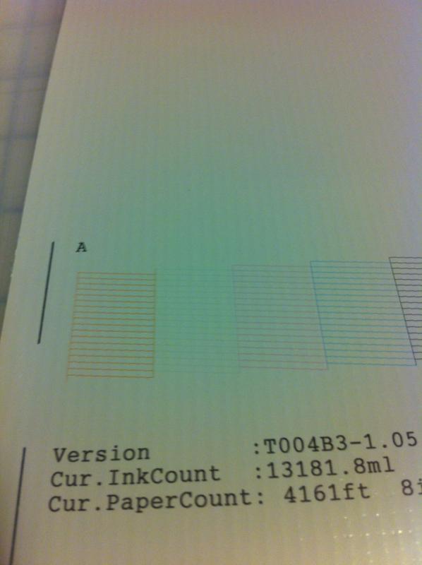

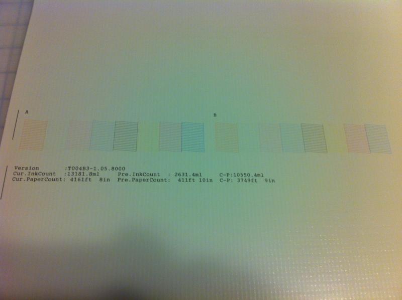

Lately our greens and grays have been printing strangely. I did a nozzle check. All looks ok, except the green and yellow are really hard to see, is this normal for others who print out nozzle checks? See attached

Try printing your checks on a different material; looks like you're using matte banner now. A gloss print vinyl will help them show up better.
It looks like the pattern is fine from what I can see (yes those colors are light). Your Loope & a flashlight should verify their solidity and quality versus the other colors.

Thank you, I printed it out on regular gloss vinyl. Looks normal to me, however the greens are still printing really muddy and strange.
noregrets
I have always had inconsistent results with my green - What I have found that seems to help is to shake the green cartridge up (by hand) prior to printing
